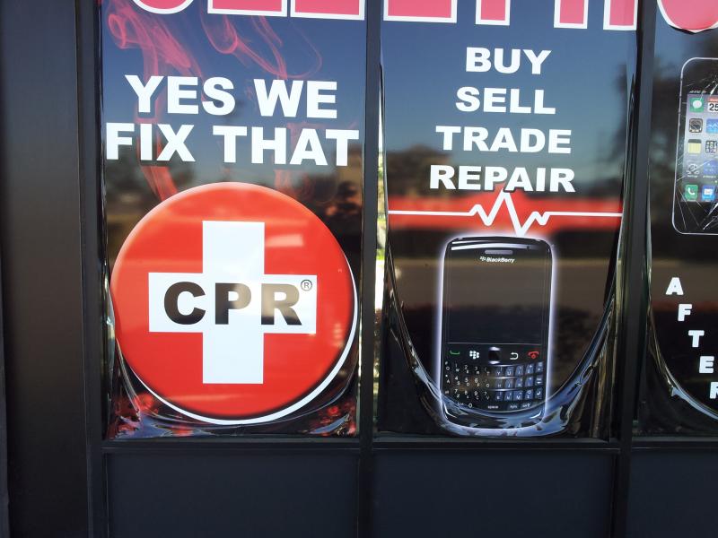

I have been wrapping windows with IJ35-C with 8708 overlam for years. I had some big windows shrink up and shrivel in high sun recently. When I notified my rep Tom, he sent a piece to the lab, and the lab claims that it's not their overlam, but it is, there is too much ink (i used the 3M profile), and that I shouldn't wrap the window to the rubber seal. I did all of the windows on the building, the only ones that had a problem, were in the high sun area, all of the other windows are fine. Shouldn't 3M be able to stand up to California temps? I would like to hear what you think.
