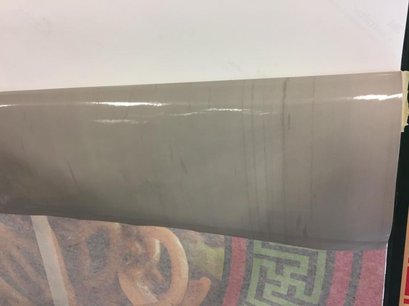

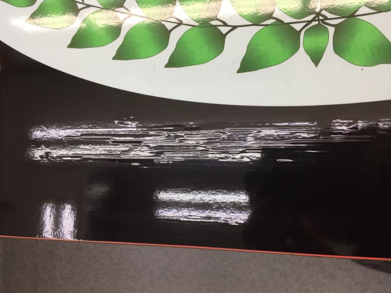

Hello, I have been using 3M IJ180 CV3 for about 7 years now and since late 2015 I have been having more and more instances of the same problem. I have posted pictures to hopefully help with the description but basically there are random areas where the backing will not stick and it seems like the bubble just moves down the air channel leaving lines of unstuck vinyl (see pic). Early on I contacted our suppliers and they contacted 3M who told them that the manufacturer who makes their adhesive had gone out of business and 3M was having trouble finding a new supplier. After a few returned rolls the problem eventually got better but for about 6 months now it is worse than ever. Another difference I am noticing is the reverse side (adhesive side) of the new rolls of vinyl have dark grey streaks in them where it used to be all a solid grey color (see pic). We are purchasing from 2 different vendors and are having the same problems from both. Anyway, has anyone else been having this problem? Also, what is another good option for long lasting outdoor vinyl to be applied to vehicles? Thank you for your help!

Never had a problem with it sticking, but we get occaisional streaks.splatters/etc on the adhesive. it seems every roll's laminate is a varying degree of gray though.
AKwrapguy
I too have noticed the dark grey stripes or even drops on the back of the film recently and we get ours direct from 3m. I have not noticed an issue with performance yet.
As far as the 'runs' in the vinyl, I sometimes get these as well, mostly on the hoods of vehicles. In my experience I think that this happens when the air channels have been deformed or closed and the air becomes trapped.... unfortunately I have found nothing that completely fixes it. Even if you pull it up and hit it with heat the adhesive is still deformed and only time will let it correct it self. I have also noticed that this happens more with solvent prints (especially reds and blacks) than latex.

The tiny lines looks like trapped air. I have that problem with 3m when there is a bubble and you press on it without poking it. It creates those lines. nothing new about that
WB
Those lines form when you trap air in the "air release" channels and try to force it out and end up stretching the channels to the point where adhesive won't adhere any more.
It's happened to me before I always thought of it as installer error rather then a defect in the vinyl.
I always try to be aware of where i'm forcing the air and make sure it has a way out.
I think it's an issue with the 3M air release pattern in general not the material. Everyone else uses a random grid type pattern that allows air to move in all directions. 3M's pattern forces air in only 2 directions which makes it alot easier to trap air.
