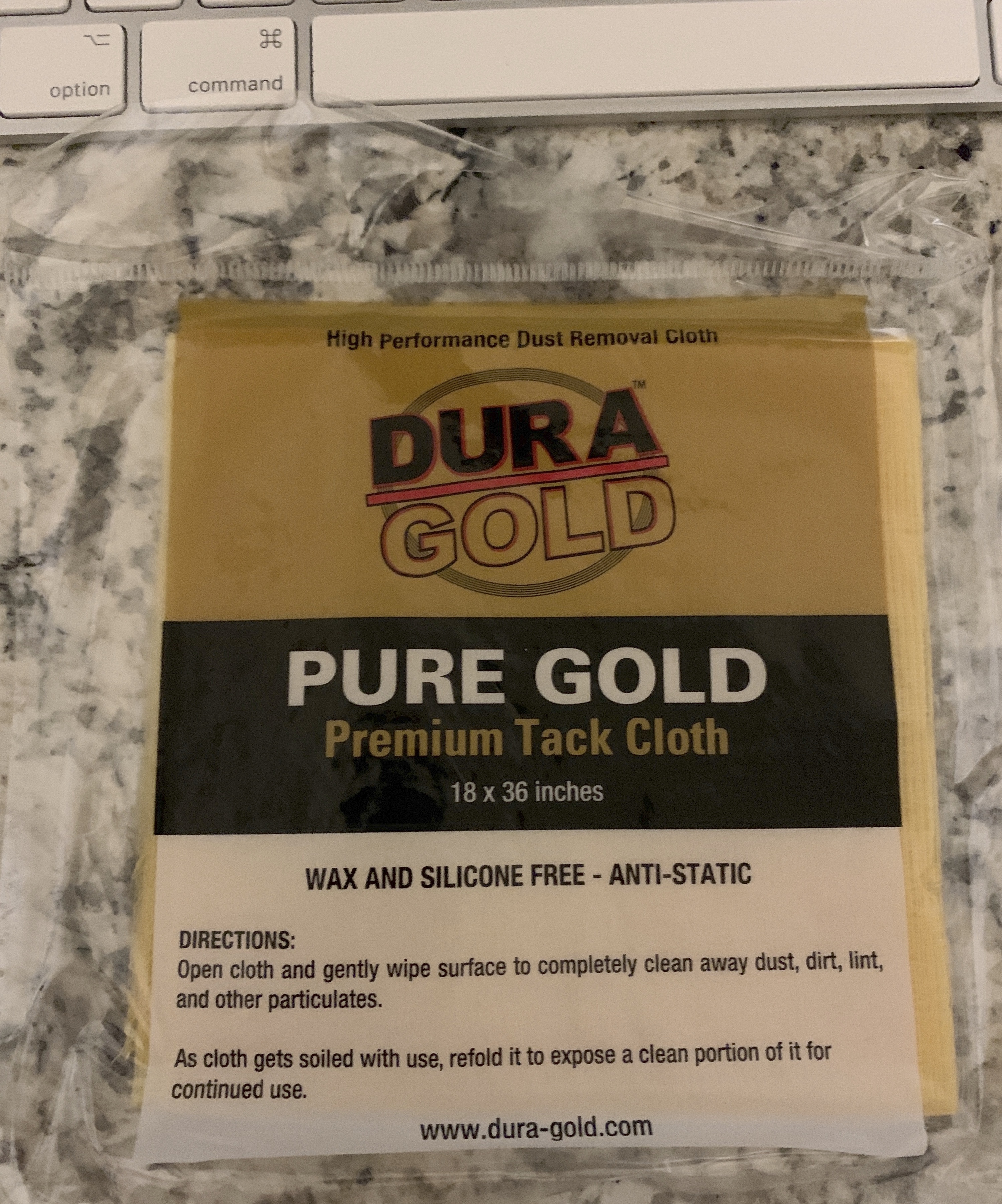

These Tack Cloths I really like. prior to ripping Latex Ink if you see some particulate on your IJ 180,
just get after it with this. Zero effect on ink, media or bonding. Ever seen a $1 mil lamb being painted.
Yeah boy that Akzo Paint is not cheap.
Gots some debris and the laminator is hot and loaded,,, and the hog tail brush aint doing it.
Grab the Gold. Also dam good on the laminator rollers too.
A box of these is cheap on Amazon.
