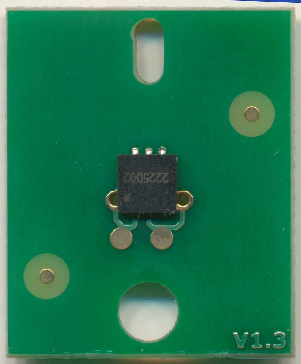

The one that came on the ink cartridge was stamped 2225D02. Ther permanent chip was marked 107A 943F3 on the chip itself. It also had W16398SB etched into the board.

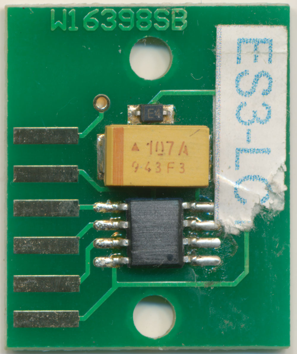

Oh, permanent chips are a pain. They technically self-reset and all, but the date can only be so far in the future before the printer rejects them. If you can post a nice clean close-up pic of the chip, I can probably ID the programming header. However, it gets pretty technical if you want to reflash those.

They are labelled accordingly. Let me know if you need to see the other side of them.

Rats, the permanent chip has had it's chip details scrubbed off. Can still see the sandpaper marks. As for the regular ink chip, it looks like a knockoff chip, but no surprise there.
