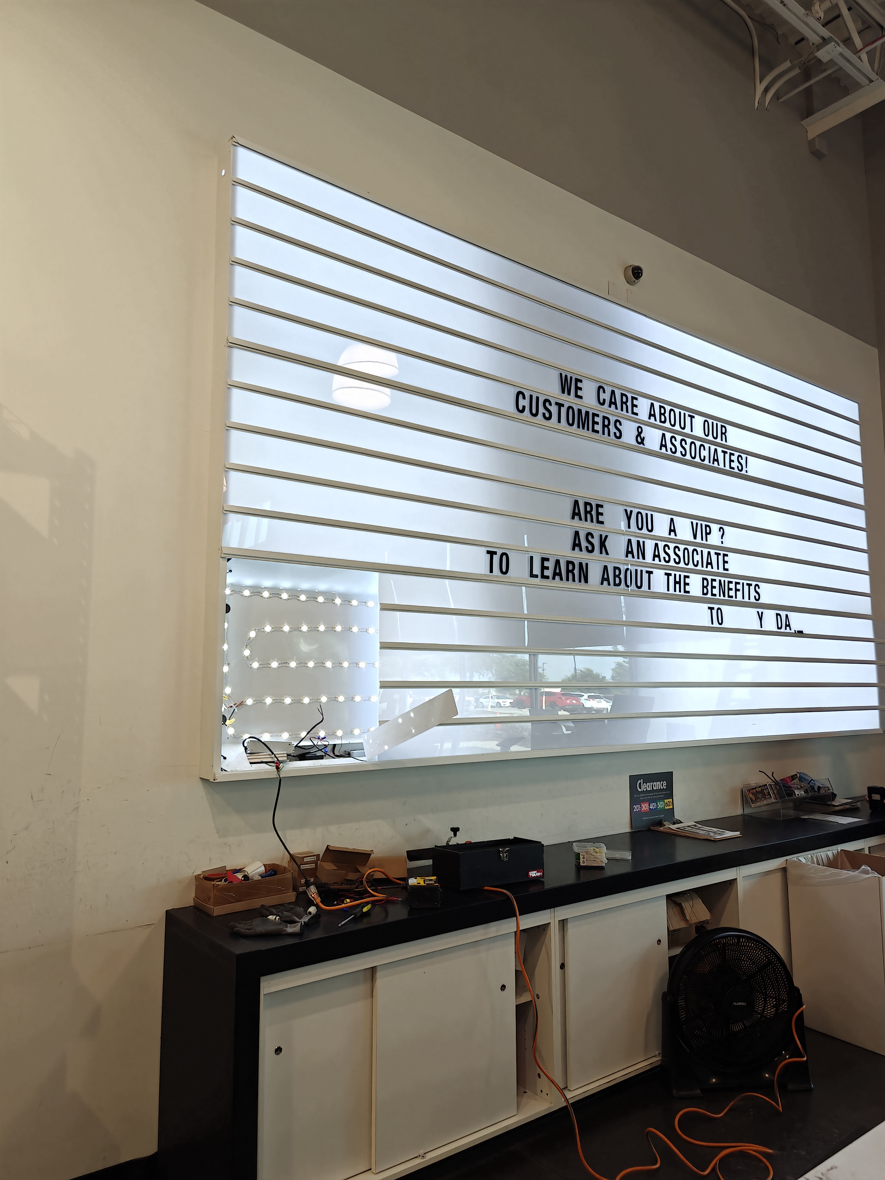

Are you asking about how to test the signage before you leave the site? . I run an extension cord up to the sign and test it, showing the client it lighting before I close it up (or take photos of the LEDs on for your client) I have a small 5' cord with plug on one end and loose wires on the other that I can quickly connect to a power supply. If no power onsite, run it off your truck. If you're going to a service call with an outage, you should be carrying around a 12v and 24v power supply anyway... just plug it up and test. That's what I did here yesterday.. quickly plugged up a new P/S and it fired up the bank of LEDs that were out.

That's some interesting track, but more to the point, what kinda joint has such a big/expensive sign in the lobby?
We call them pigtails, mine has wagos on it, saves the hassle of straightening the wires out every other time with wirenuts.

I can't slide the face out of the track cause there is a shelving unit in the way. Have to make a second trip to remove bottom retainer with a helper. Waiting on them to approve second PO...even though I told them all this before I went out there and looked at the pics.
