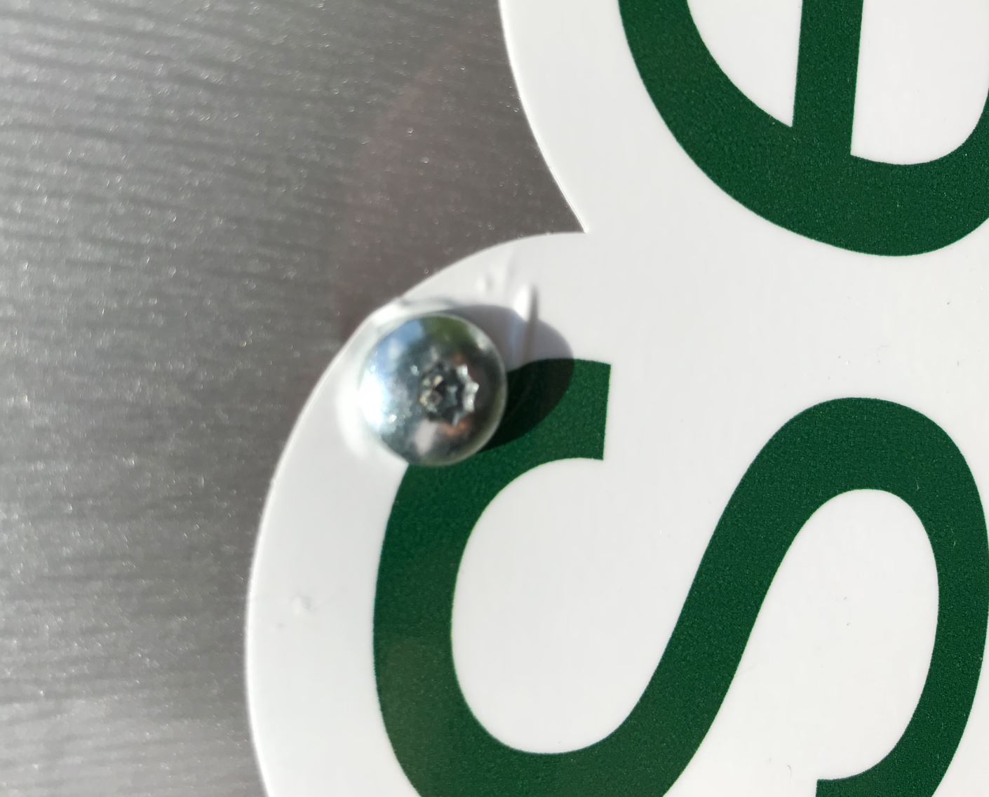

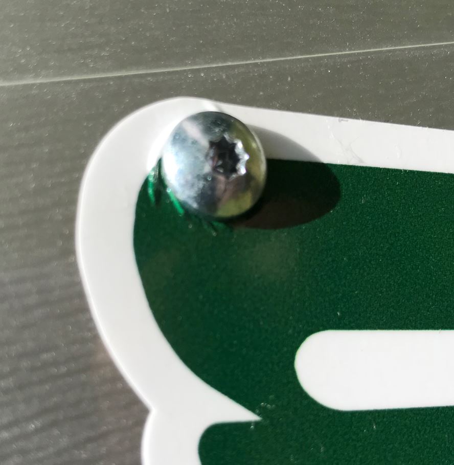

Not sure what happened. Ink dried for more than 24 hours. Where I put the screws back in the vinyl twisted more than normal. Saw the trailer 3 days later and vinyl is spreading around the screws and also coming up a little on the seams.
klingsdesigns
It has been hot here and trailer is sitting in the sun, but never had this happen before. Not sure if its because of the 8048 being so flexible or what.

I looks like you just over tightened the screws.... Did you pre-cut the holes before putting the screw back in?
klingsdesigns
I do it the same way since 2005 and never had this issue. I either put an x with the knife or pierce them with screw. When i star them i heat up before i put in screw. Also when i tightened down It just touched the vinyl and twisted. Usually i can get them tighter than they are. Then when i backed out the screw i couldnt even get the vinyl to lay flat again, with heat or not.

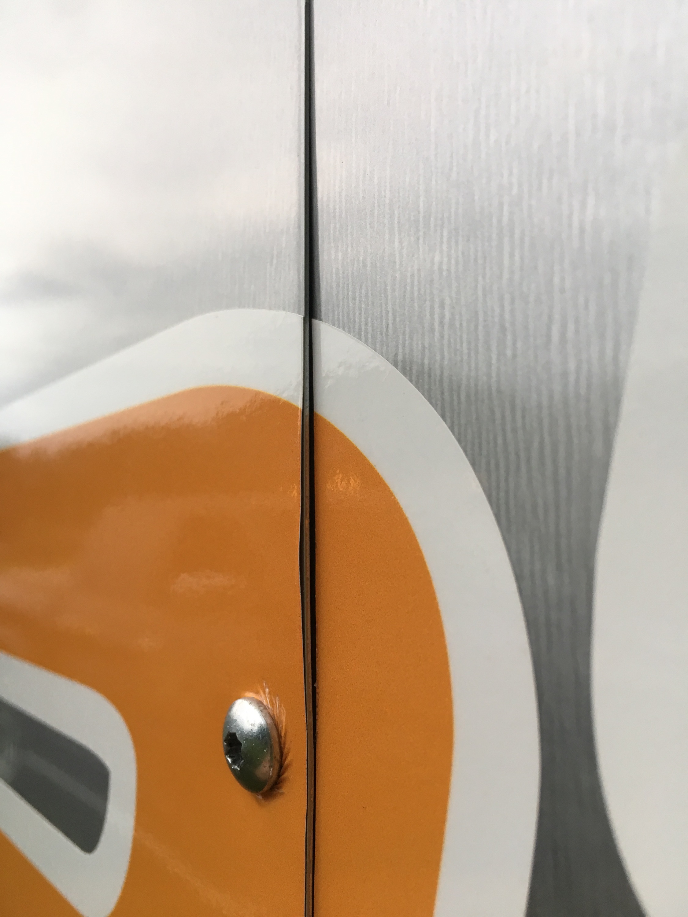

I just tried to take a few screws out heat back up and try to lay flat and use a square head driver and hand tighten. Cant even touch the vinyl without making it twist. Also here is a picture of the seam lifting.

My first instinct would be prep issue. But I also know that some people will use silicone on crew holes and seams that leak, so it might be that as well.

I have never lettered this brand of trailer before. And it looks like when it was made the screws were tightened a lot where the metal dimpled in behind them. Vinyl should still stick. We did go over ever hole and trailer with iso. I am going to take a some squares of vinyl and different brands and try putting over a screw hole and tighten down and see if it is just the 40c that is doing it.

There can be some twisting around screws with anything but I stopped using 40c over a year ago, it's crap. Had to re-do quite a few projects that were curling at the edge, like you have at the trailer seam.

Not true. I took a piece of old 40c , new 40c and ij175. Old 40c twisted a little bit, new 40c twisted a lot, ij175 i tightened so much it pushed through the vinyl under the screw and it showed very little twisting.
Christian @ 2CT Media
To prevent twisting we have added the clear silicone washers on trailers we have removed screws on, it provides enough cushion to prevent twisting.
As for the lifting and failing, I honestly think its 40c. 3M seems to be either having a consistency failure on their adhesives or they are changing formulas again.
Asuma01
A line of 3M primer 94 on that metal seam will do the trick. But since its already applied you can probably fix it with 3M edge sealer.

I ended up putting edge seal on the seams of trailer for now. Hopefully that holds. If customer doesn't like the ripples around the screws I am getting a new roll of 40c today and will reletter it. Hopefully this roll is a little more aggressive on the adhesive.
