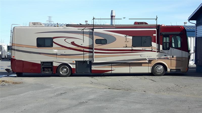

My friend is running a bodyshop and he's having so much requests for big RVs he has decided to jump in it... guess who's been asked for "find a way to create paint masks to help my painter"...
I only have a Mimaki CG-61 24" plotter for decades and the option to use my Roland VS-540 hybrid printer as plotter but as I may have yards of paint mask to prepare for each unit, maybe it will worth investing in a dedicated wide format plotter. No need for any "crop-marks finder" as my Roland handle pretty well it's own prints/cuts.
What would you recommand for "best bang for the bucks" / reliability / trouble-free / easy to operate cutting device? What would be the price tag (average)?
Thanks
*the kinda graphics I will have to do...

I need a 54" plotter I think... Media will be cut close to edges so don't wanna get a 48" plotter that will only cut 44" ...
He's way more "business" than me so I figure he keeps a good mark-up. He just moved in a bigger location with a 50ft long, 16ft high paint booth and he's selling RV for living (he had run a bodyshop for 25 years).
He wants really complicated masks so once a base color is applyied, we'll cover a section of the graphics, than cover for the next color and so on... He wants 'em to be painted like factory (and big rigs too)
