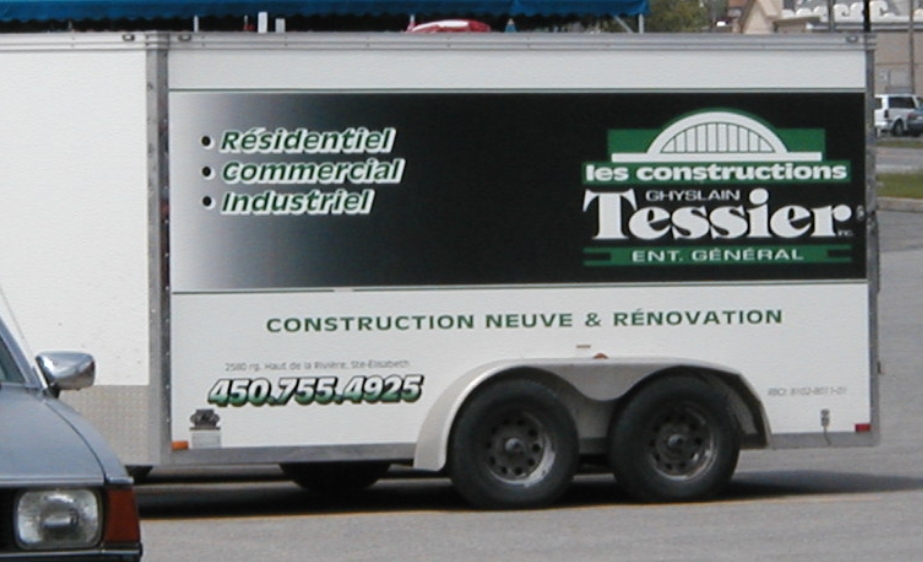

'Always used OEM Roland inks since 2004 and I swear, I have jobs on big rigs that reds are still red, not pinkish, not orange... My profiles are kinda generous on ink coverage which makes the colors to stand the time. Before I bought my 1st printer in 2004, I sub 'em to a guy that printed from a Vutek + liquid laminate. I made a job for my neighbor, a construction guy, and the green hasn't lost more than 10-20% of it's vividnest. Job is +13 y.o., always parked outside, never washed. We're in Montreal, Canada sure... not in Southern India. Our range of temperature is from -35°C to +35°C. Humid, not desert dry.
Thickness of ink makes the difference, I assume.
Can we increase ink thickness on a Roland ?
Thanks...
Thanks...
I use a profile for matte vinyl but on gloss. The profile has been "tweaked" by the tech as he was performing initial testings at installation. I'm not really into "in-deep" details as for setuping custom profiles but it's in saturation somewhere... he tested the limits before the little squares printed turn darker on the edges. You can see ink thickness... You drop just a bit before that ;)
