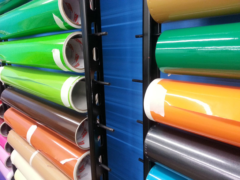

We used these for our DIY vinyl rack...
http://www.menards.com/main/electri...annel-12-gauge-green-10/p-1628627-c-12477.htm
Then we used 1/4" round steel rods to hang the rolls from. We spaced them about 26" apart and the rods are cut to 30" long. It works great for 15"-24" rolls of cut vinyl but might be a bit cumbersome and hard to manage for hanging 54" rolls. Just figured I'd throw the idea out there, though. This could be fairly easy to modify to fit your needs.

phototec
You can get the Half Slot Channel Struts and metal rods at Lowe's;

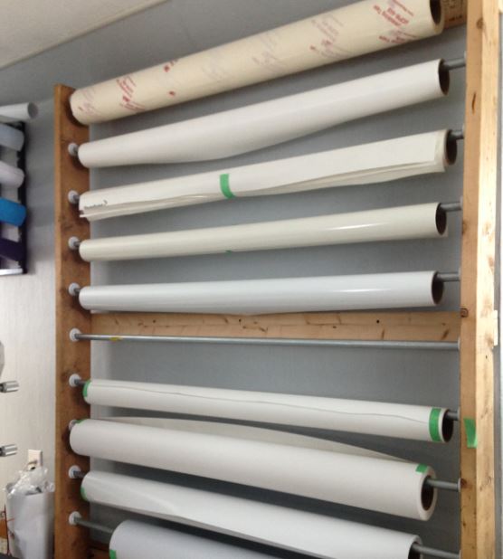

Rocco G
I made this rack years ago. It's just 2x3 lumber with 1/2" electrical conduit inserted at an angle. If I were making it now I'd use 2x6 or 2x8 lumber so it could be even more firmly attached to the wall to handle larger rolls. I would beef up the conduit too. When I made this all I had was a 15" plotter.
Hmm, looks like I need another couple of rows from all that vinyl stacked on the table.

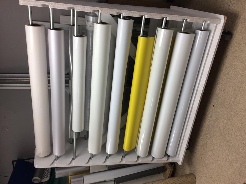

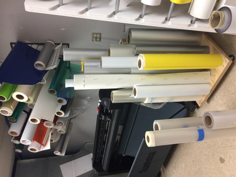

Our Media Racks
This is what we have come up with over the years to hold our media. The racks on the wall over the Summa were first when we only had a 30" plotter. The vertical rack was our first attempt to hold vinyl/laminates for our HP Latex and then someone on here posted a rack similar to our horizontal media rack. Its on casters and is double sided. I think it holds 17 Rolls up to 54". We cut and built the whole thing in house.

Wensco Mike
A quick fix if you don't want to build something, is a Media Rack at Wensco.com. It holds 16 rolls and is on casters so you can move it around the room if you are lacking space.
ProColorGraphics
Would you be willing to share the dimensions/templates you used to build the floor rack? That looks nice!
