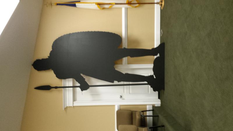

If the end result doesn't have to be perfect, you can even seam 3/4" plywood fairly easily. This 10' tall cutout was made from 2 sheets of 3/4 plywood. CNC cut, then seams were fastened with a Kreg jig, wood screws, and glue. The seams were slightly visible so it's not the best option for every application, but it worked well here.
