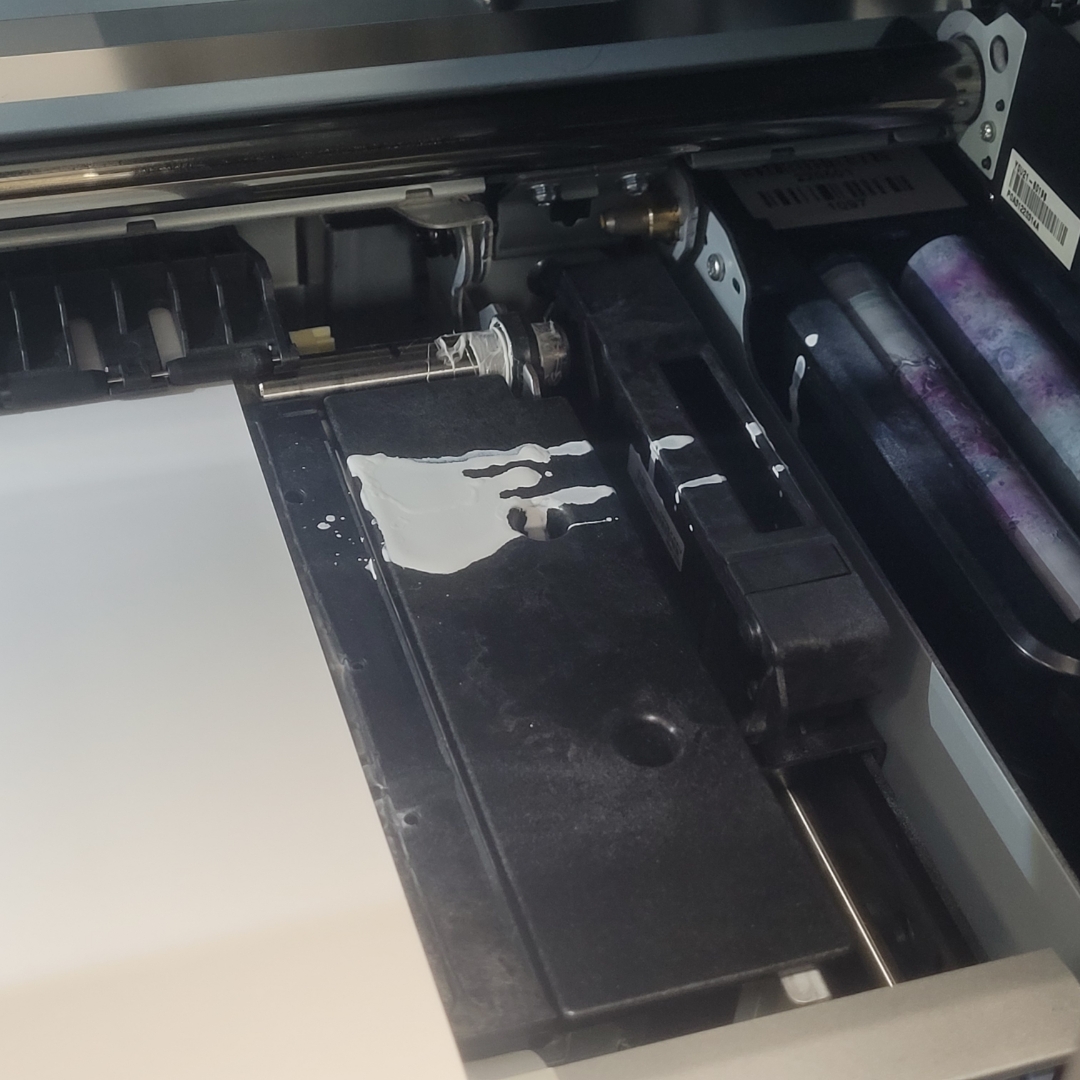

Brand new machine. There was a minor head strike during install, so maybe it’s related? The tech was nice enough to send 4 replacement heads, but not of them are white. Anyone else seen white ink puddles like this? Install was 5 days ago, printed 4 inches since with no problem.

White printhead could be fucked. You should see which one from the bottom. Don't put it back.
Another possibility if the carriage was idling there after the crash for a while, it could have just dump some ink there, not a big problem.

This happened to me probably about every month. Sometimes it would be printing and leak onto the print, sometimes it would just leak into the maintenance cartridge.
My second printer did this twice in the first 6 weeks. HP was 0/2 for me on the 700w. Both printers I sent back had white ink residue all over that location.
I would say get used to this and be prepared to have hp send you new printheads all the time.

Thanks guys! What's the best way to see under it? Pulll it out? Or is there a way to move the carriage to a spot where it's visible?

Just use the task to replace the maintenance cartridge and reseat it after verification. You can easily determine the faulty PH when seeing the capping.
Did they not give you any training....? You are supposed to take out the printheads and put them in the storage when you don't use em... and at that point it's pretty easy to see how they look, how caps in the maintenance cartridge look and also if there is any ink puddle in the storage box caps.

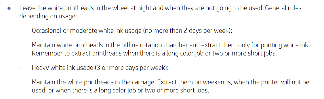

They say to extract the white print heads when there is a long color job, I guess the implication here is a long color job with no white?
So basically, if it's not printing white, unload the white heads? That's a pain, and I guess it's too expensive to print white under color constantly unless it's required for the job?
Yeah that's what it means. It's so easy to take the printheads out and if you leave them in it's just cleaning them more and you will waste some white ink (and maintenance cartridge) on that.
If you can just by any means pool your white ink jobs for one day of the week or two days, just keep em in during those days and take em out after. After all I think it's rare cases that you would be constantly mixing up color and white jobs every day. And if you do you just keep them in forever.
I would personally just take them out at the end of every day if there is no white job in queue for next morning.

We print white on almost every job. We have deactivated the circulation systems on all our UV printers because it just doesn’t apply to us.
I do think we should remove them on weekends. After I get some data from the first set of heads. Let’s see how long they last in each scenario. So far it looks like cleanings take 1.5 percent of the white ink per day.
