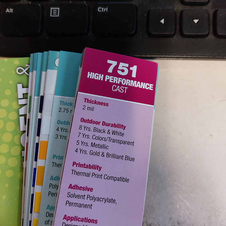

The official spec sheet says the metallic have a 5 year outdoor life but can be shorter depending on how vertical the surface is. If you're using any of the "brilliant" colors, they only get 3 years. However, the spec sheet does call it all cast with no mention of calendared.

i think it's just because it's metallic. metallic doesn't hold up as long as regular colored cast vinyl.
especially if it experiences extreme weather conditions (heat, sun and cold)

I have a color book too and seeing this again helps. Here in West Texas we always take a year off what it says it's rated for so this makes sense, except that it probably looked new for two years and breaks down before three. I really think the sales rep is wrong too. It's gotta be a cast. Maybe bottom shelf cast like some car wrap material that's kinda new and is a combination of both. The price is also like calendared. Just slightly higher than 651 and then 951 is very noticeably higher. Think I'll just start using the 951 where it's gotta count. I hope this helps some folks thinking the silver 751 will hold up to it's expected lifespan. We've had no issues with any other colors BTW.

It’s a cast film,
Silver or any metallic vinyl won’t last as long as non metallic cast film, also a bitch to remove because if tears in little pieces. Have to heat it and plow it with a little chiseler.
