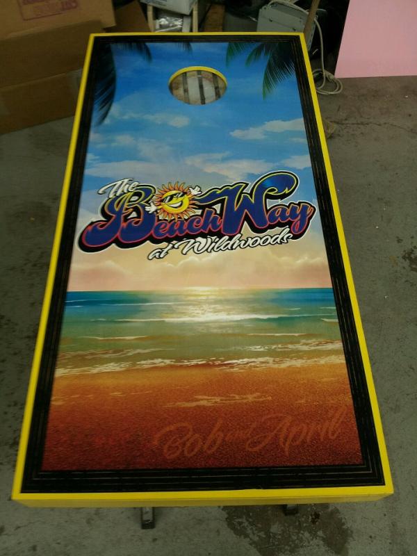

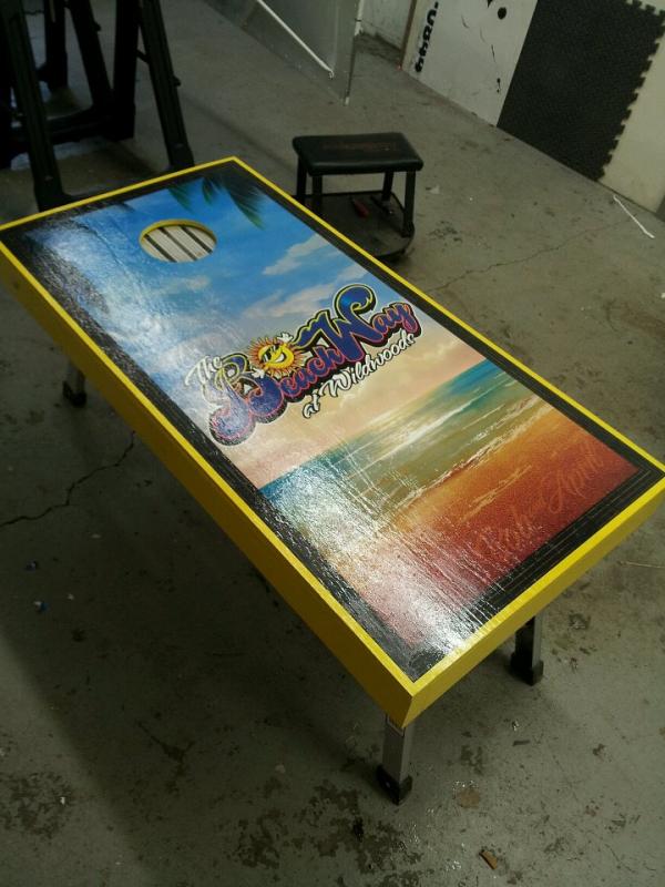

Just finished these for a friend for his beach house. Designed completely in Signlab and outputted to my dc4sx. Wrapped and brush coated with outdoor polyurethane.

ptegolf
What substrate did you use? Is that CMY or CMYK? I have a DC4SX and wouldn't attempt something like this, but I'd love to know how you did it!
ptegolf
Ah ok, I saw the grains of the wood through the vinyl and was wondering how you got it on there so clean, I've never tried filling, sanding, then painting before applying. What did you "fill" it with?
Ursta Graphics
Wood filler ... then use a rivet brush to smash the print into the grooves. 4 coats of outdoor polyurethane keeps anything from lifting.
