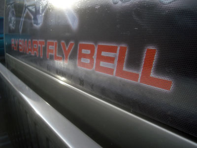

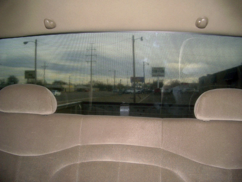

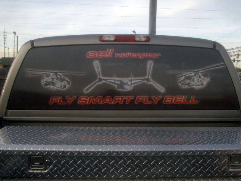

I figured I would revive this thread... We did an install on a truck rear window today. When installing Perferated Vinyl w/ laminate is the outside suppose to look somewhat hazy? When looking from the inside out it looks good like looking through a screen patio type thing. However the outside is what got me concerned. But I believe this is normal and over time it should look better...

install dry. no premask, center hinge. PERIOD. easy as hell. USE ONLY an optically clear laminate if you laminate. such as the 290f. the haze is from using a non optical laminate.
