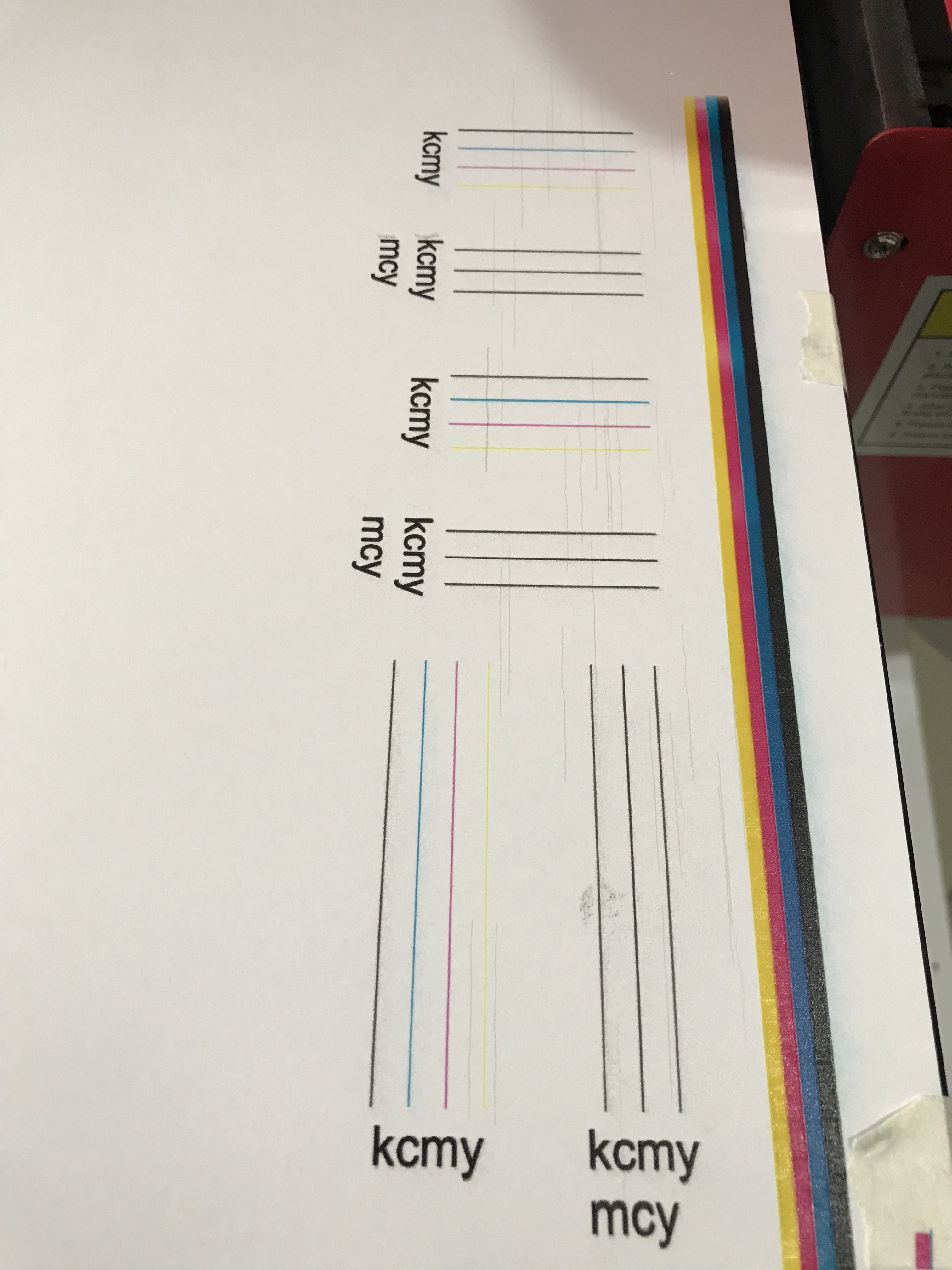

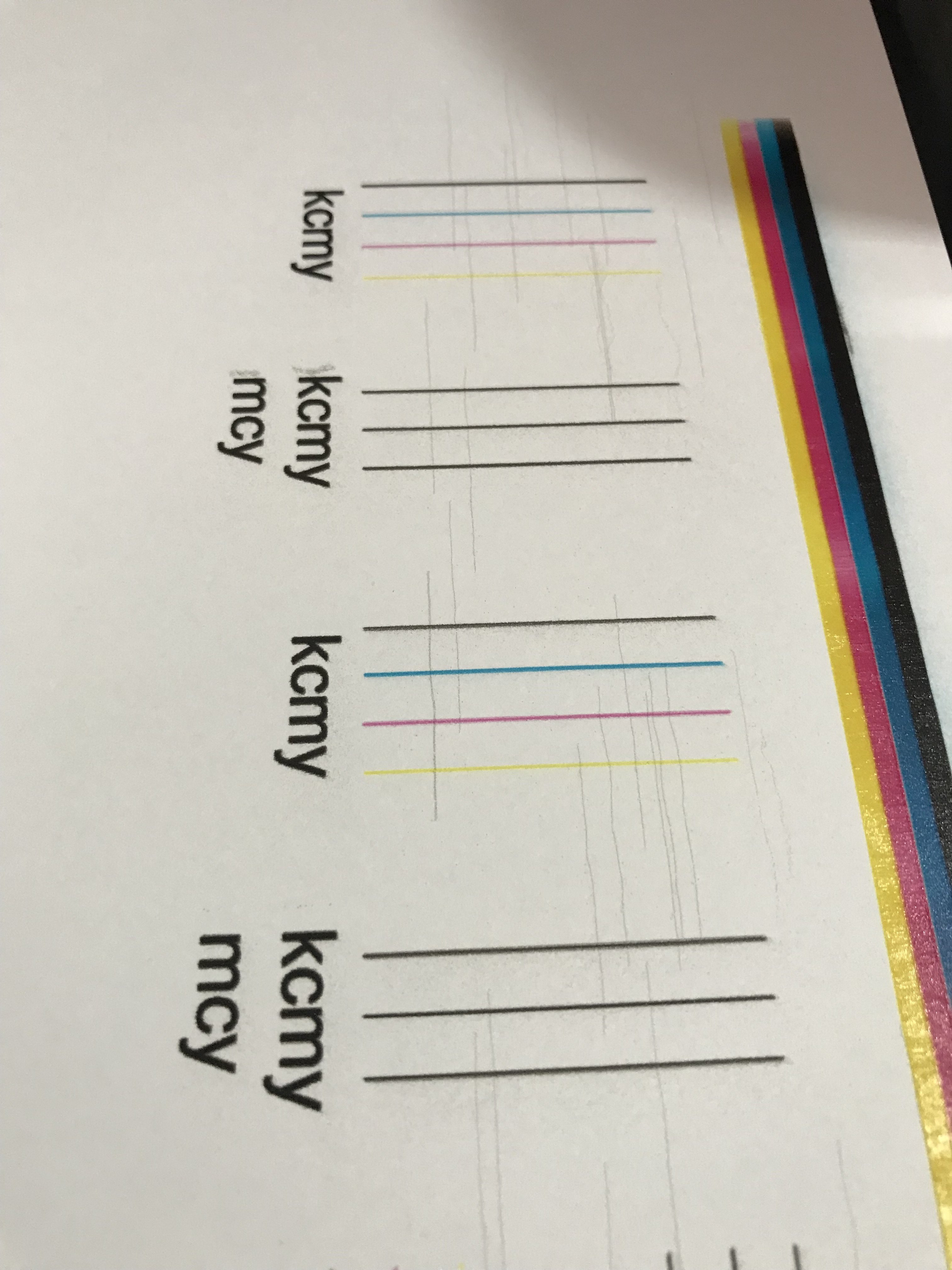

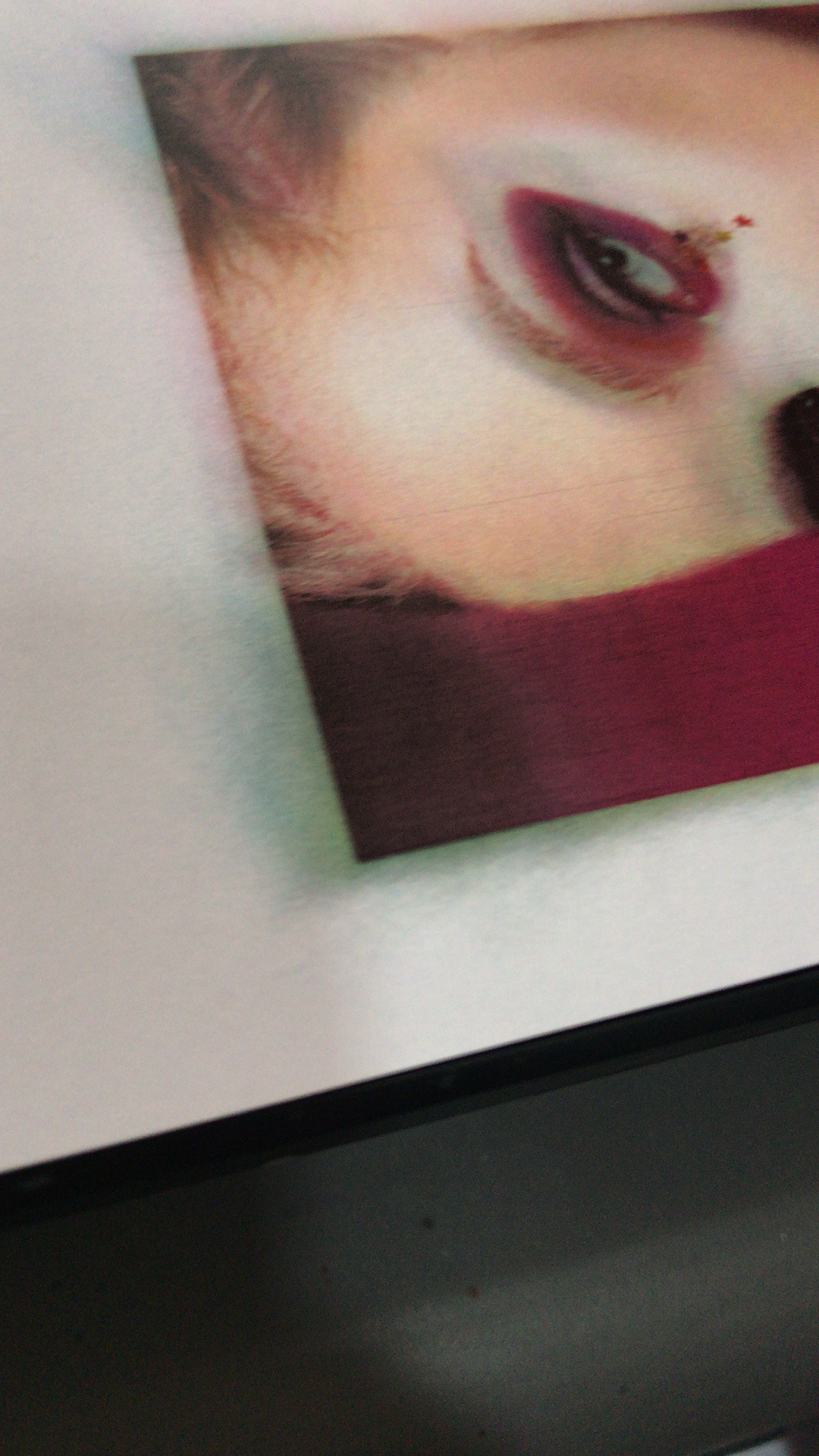

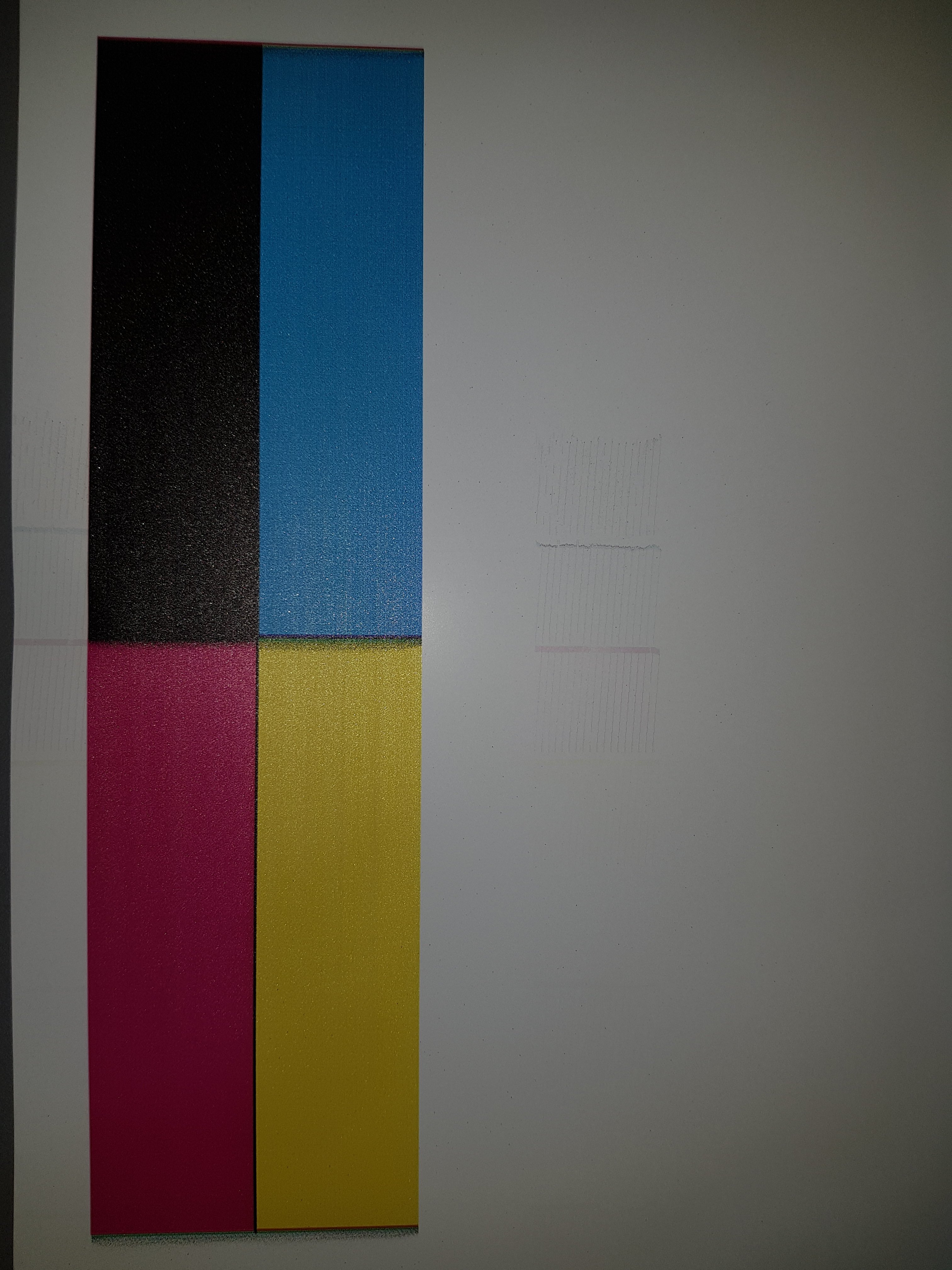

Hello.im new here and i hope someone will help me.
I got a A3+ UV Printer from china company and i have problems with print.pls check the images anyone can help me to fix this.
Im using the software Wellprint XP and for RIP UltraPrint
Any calibration tutorial or print files.will help me

It looks like at least one of your problems is that you are printing too high. The fuzziness around the edges is a sign that the nozzles' focal point is higher than your substrate.
ScriptMan
Thank you. yes it fixed. now i print on 2mm and quality fixed. I think holding glass is not at the same level in all corners how i can fix it to be the same on all corners.
