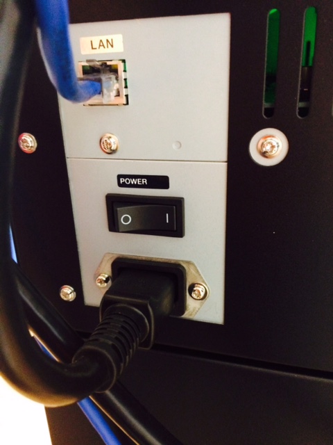

Hi everyone, just installed Pro4 XR-640 a week ago, as i know the machine needs to be plugged 24hrs but should i also turn off the power botton when i off the work? because i can hear the electricity sound all the time.

leave the power on all the time. It has a cleaning cycles it must run.

+1 to leaving it on 24-7. the cleaning cycles and ink circulation help keep the lines and heads from clogging.
