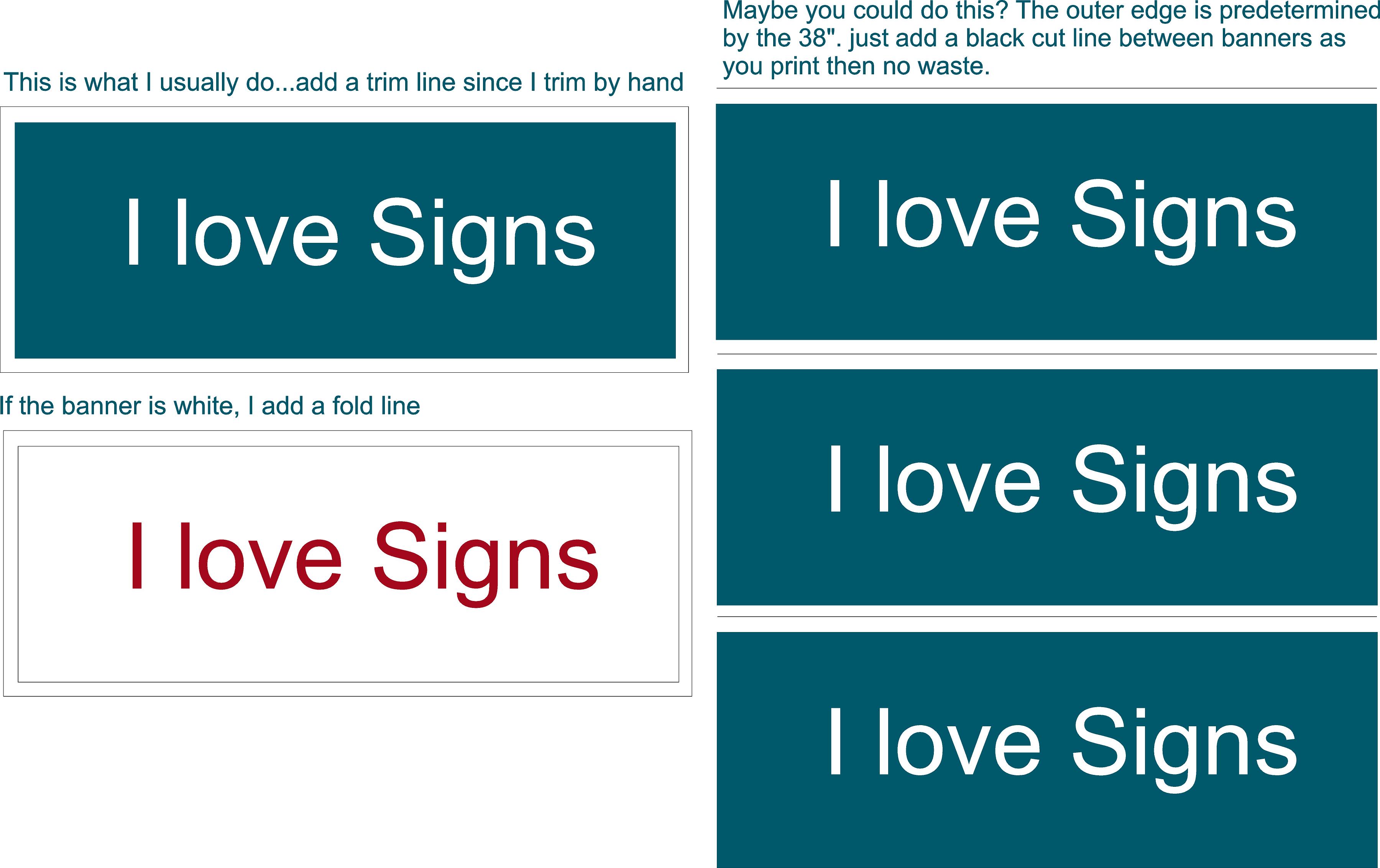

I like making signs
This is what I do...I have to trim by hand, no machine to do it for me.

One of the first banners I printed was around 38" wide and 2' tall. It was one word...FREE on a white banner. I printed it and it's just a word on 54" material, so I had to measure where the edges were based on the word being centered - waste of time. After that I made some templates for the common sizes with the bleed/cut line and fold line. IDK, I did it and it just stuck LOL

If I have a white banner I'll add a thin light gray stroke around it for a fold line. Just saves me the step of measuring and marking two inches on the back. It's an easy shortcut.

I have Onyx setup to put a dotted line at the edge of the print, and then another dotted line with one inch of bleed past that edge of the print.
It makes cutting and folding so much quicker..
If we were doing a 36-in print on a 38-in roll we probably won't have any lines. The back ham does have a line you can somewhat see if you're looking, but with it being dotted and so spread apart it's not really noticeable plus when you fold ,your folding right on the line so it ends up in the crease
