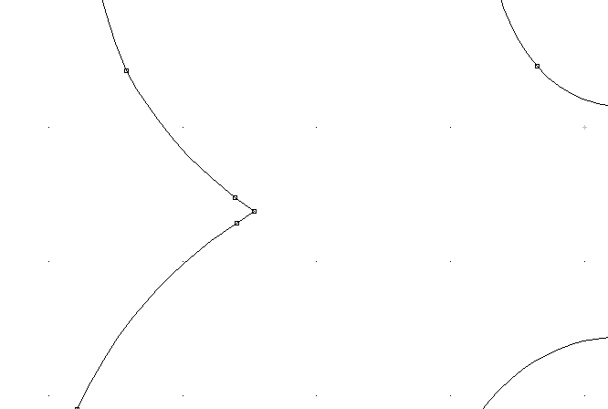

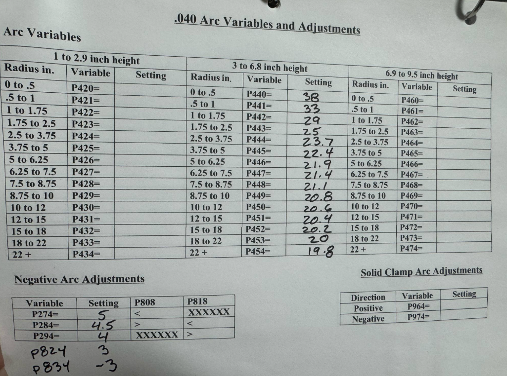

hate hate hate serif lettering on the accubend, but we've managed to make it work via a bunch of calibration testing & value inputting.
its been so long since we've had to go through the process, but our CC tech walked us through it at the time.
beyond that, your offsets are the same as mine. approx. .125" offset from aluminum shape is the plexi shape, and .02 offset from aluminum shape to make the accubend shape (assuming you're using .04" coil)

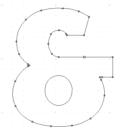

node editing is crucial as well, as the machine does not like having a curve before a bend, so I manually add nodes and convert arcs/curves to lines at hard bend points.

That part I was not told about. So basically if there's a curve going into a line, I should convert the end of curve to a line?
