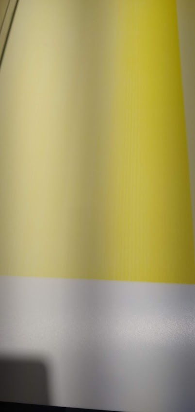

our Fuji printer seems to loose Y ink really fast and can't figure out why. It starts off normal and then after a couple of minutes of printing it gradually starts to fade quite noticeably. When you pause it and let it rest for a second, it starts off good again but then it starts fading right away.

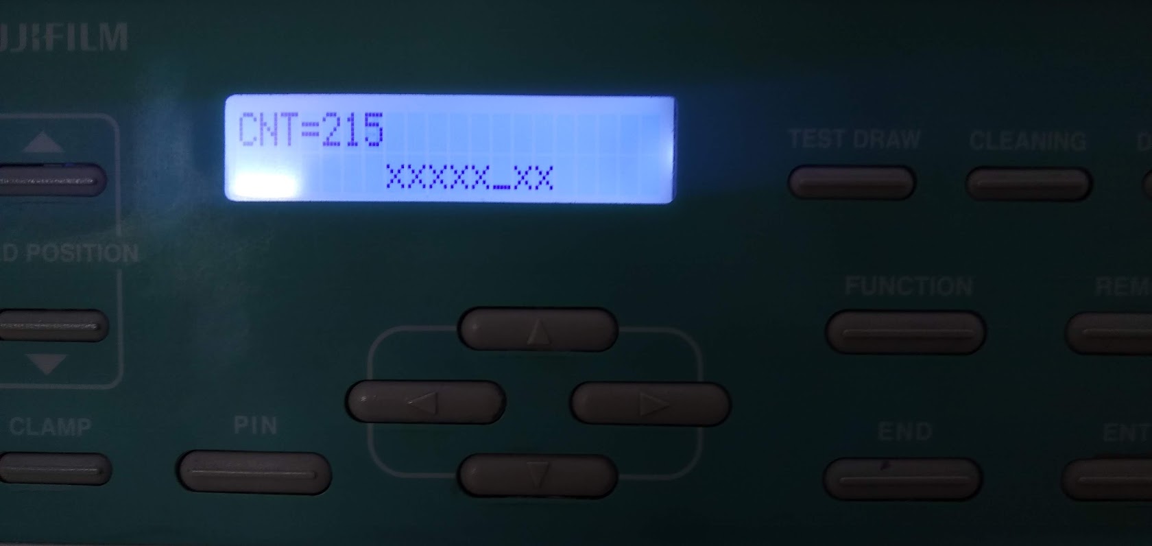

Under "Check Ink IC" when I select the 6th ink (Y) it starts counting to infinity with no futher message

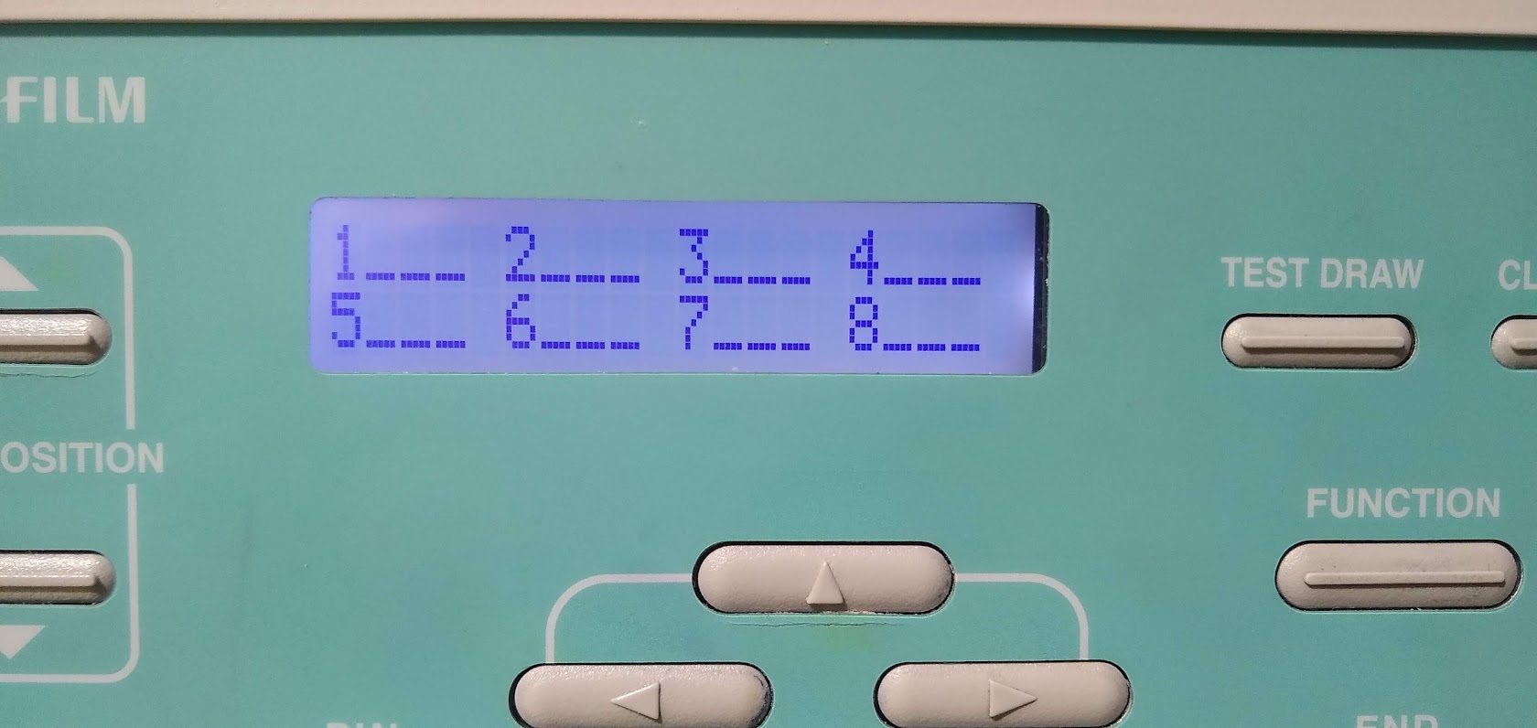

Under "Checnk subtank sensor", all I get is this message and all I can do is go back

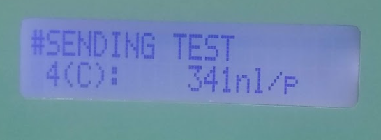

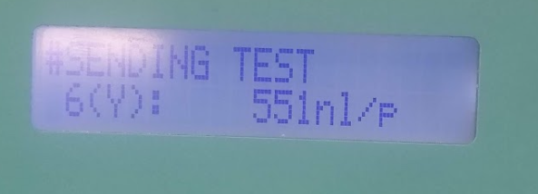

As for the SENDING TEST:

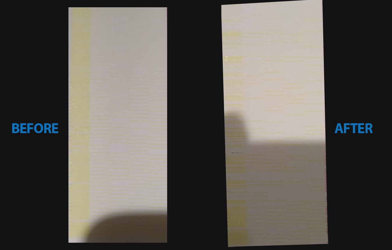

And here's photos of the test print before printing and after:

Value for the C channel is good, for the Y is too high. Don't adjust them manually (I know it's possible, but don't do that). Again - seems that there's a false air in the system. Usually, it's pain in the ass, as it's difficult to find the loosen connection. Try to follow all ink and vacuum tubings from the head to the ink pump, check all connectors, also on the degas modules (black plastic tubes inside the carriage, on the left side, under the metal cover). It's also possible to swap ink tubings between two heads and check if the problem moves (this means, that it's somewhere in the ink delivery system) or it will stay in the Y head (which means, that it's in the head itself or in the ink vacuum system), but it would require a lot of head cleaning (mixed inks will contaminate colours). It's doable but time-consuming.
