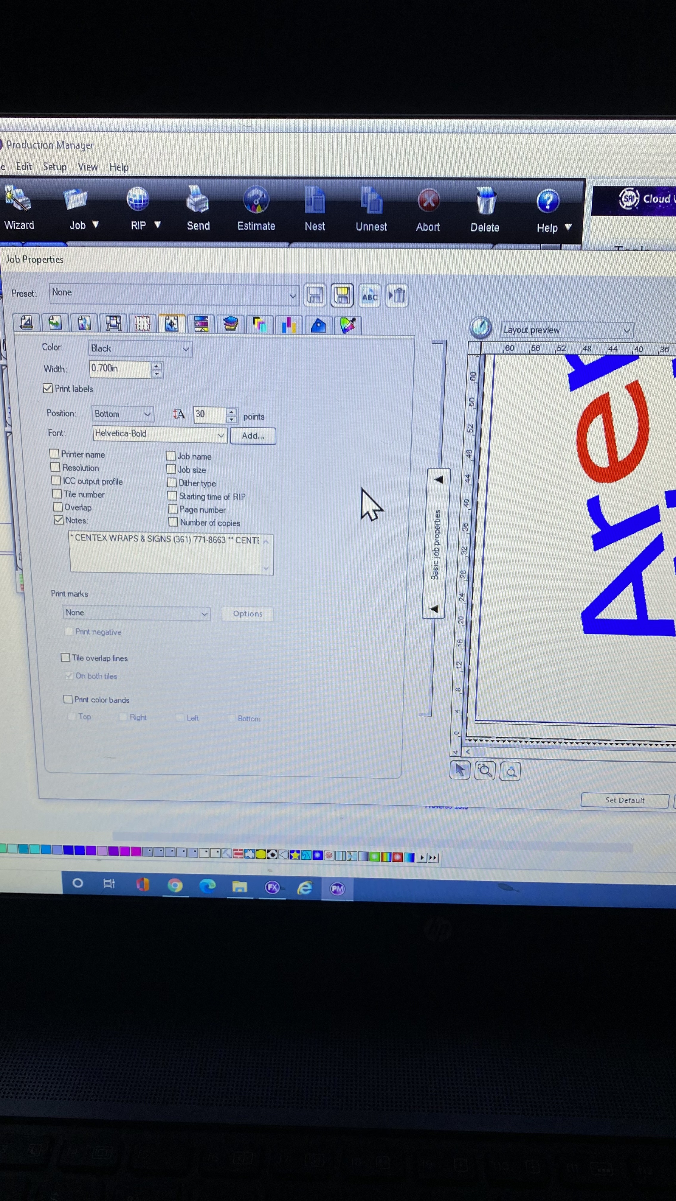

That is what I have selected through production manager. I repeated the name in the box until I got to the end of the box the deleted until I got to the end of a repeat. On the print itself it then has all the details of the rip like media, curing temp, pass, etc

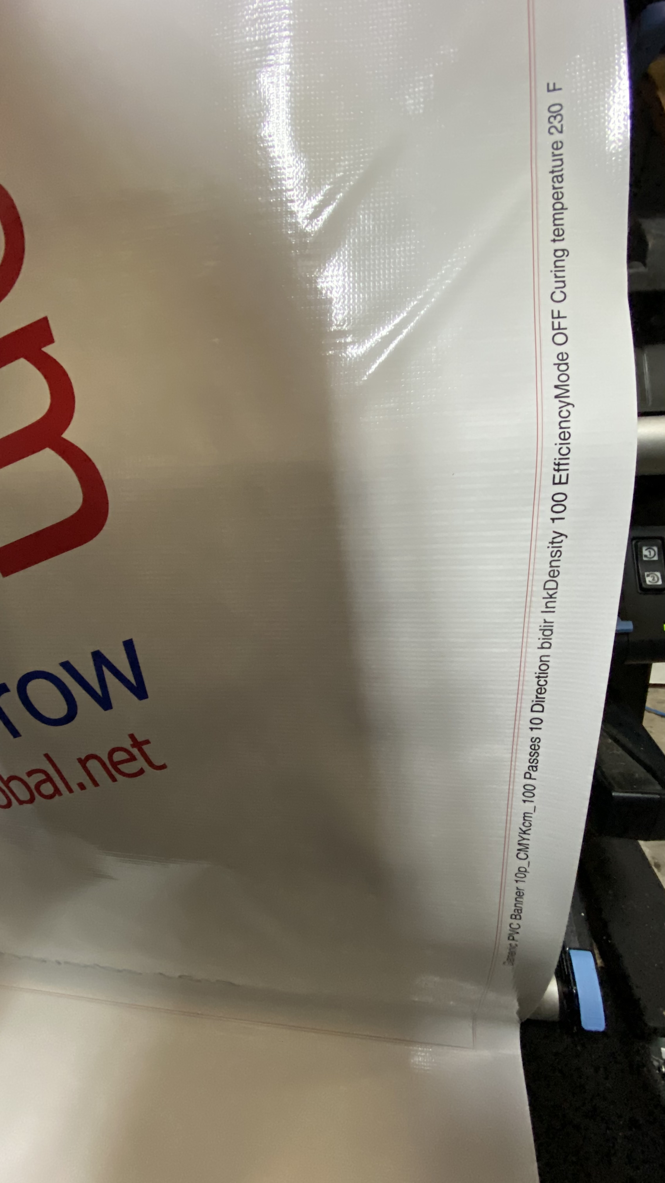

This is what it prints with print labels checked but not having the notes checked

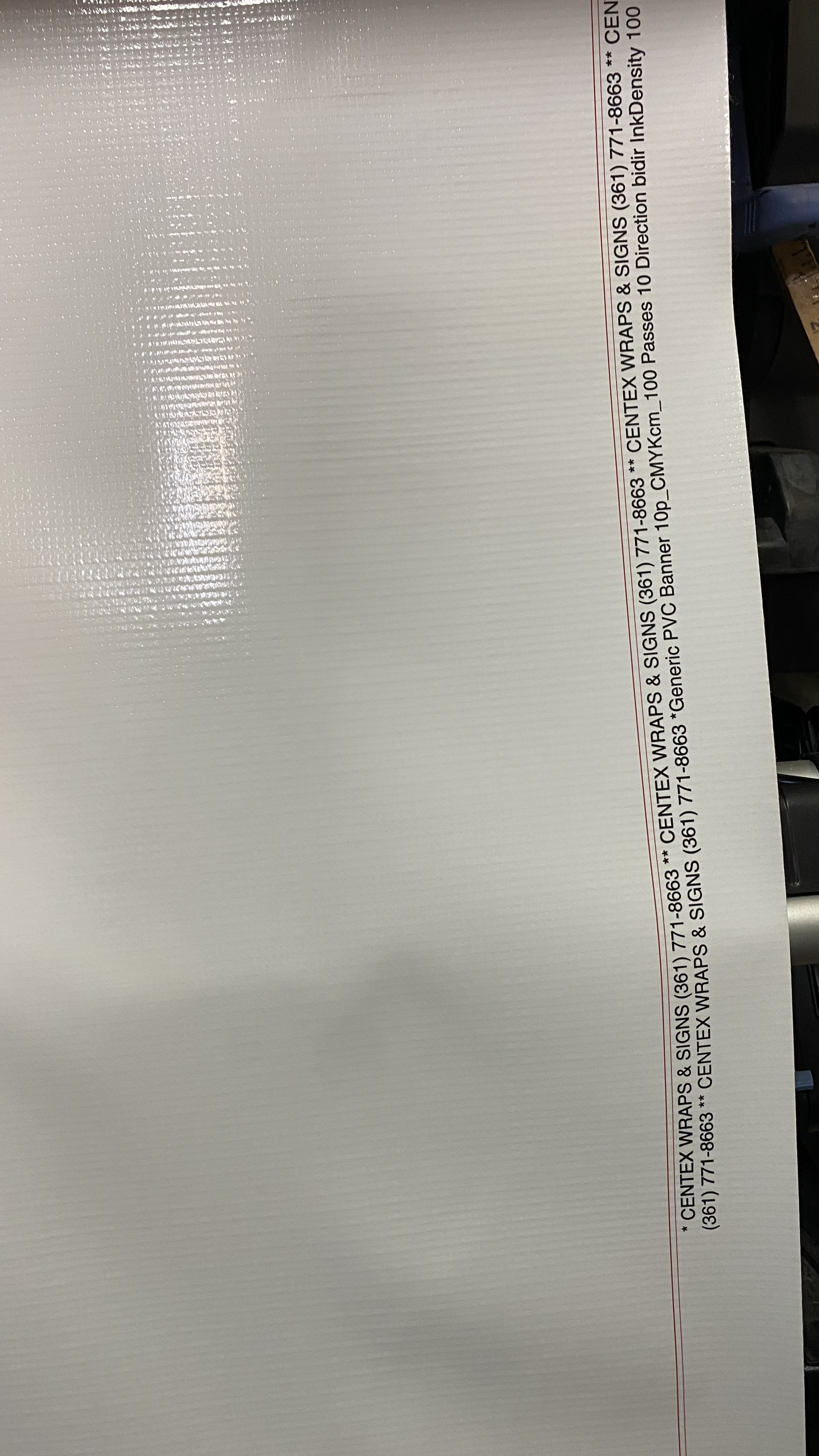

And this is with labels turned on and only my text in the notes box as mentioned in first post
