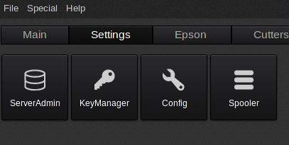

1) Go to the Settings Tab :
attachment.php

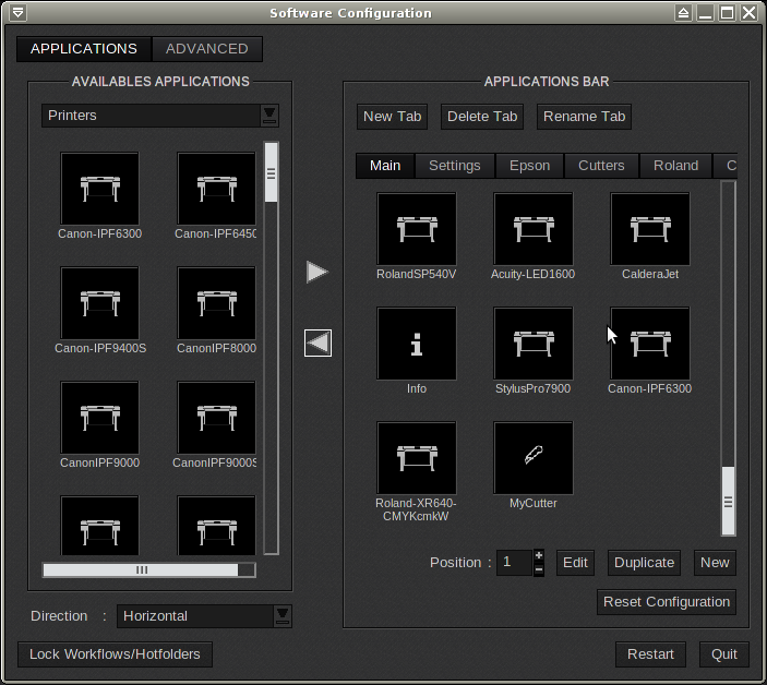

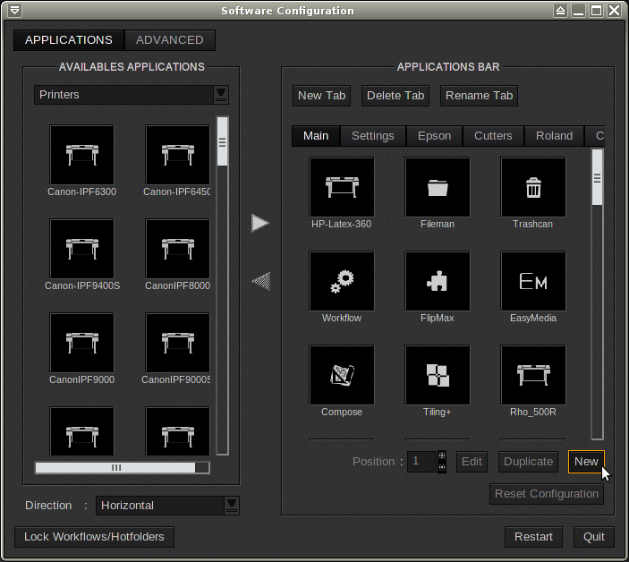

2) Into Applications Bar, click on "New"
attachment.php

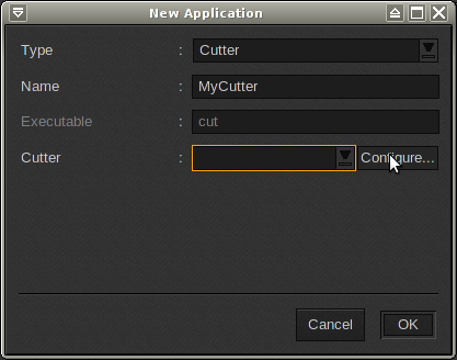

3) Then select "Cutter" as type of the new application, and the name used for the cutter.
Pay attention that spaces are invalid characters here.
Then, in "Cutter" area, click on "Configure" :
attachment.php

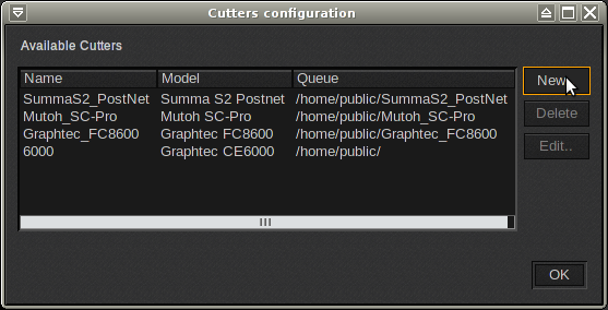

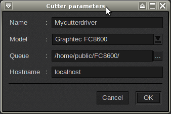

4) The new cutter may not be in the list, so click on "New" :
attachment.php

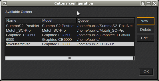

5) Enter the name of the new cutter. Here, space character can be used.
Select the model using scrolling list of all supported cutters by Caldera.
Then enter the path of the queue that'll be used by Caldera to save the cutter files.
Note that you can reach a mounted folder in case of cutter controlled by another computer.
attachment.php
Click Ok.
attachment.php
