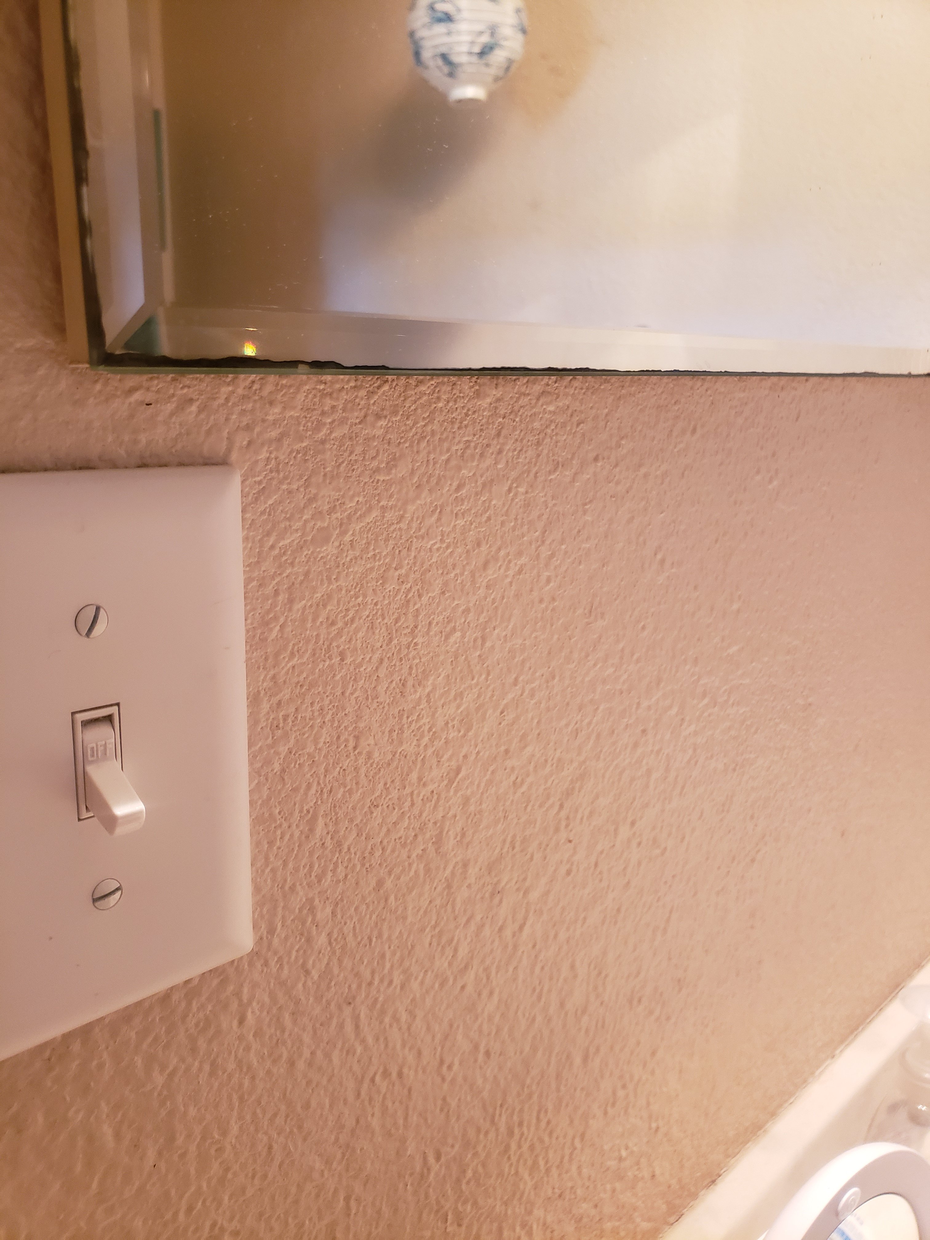

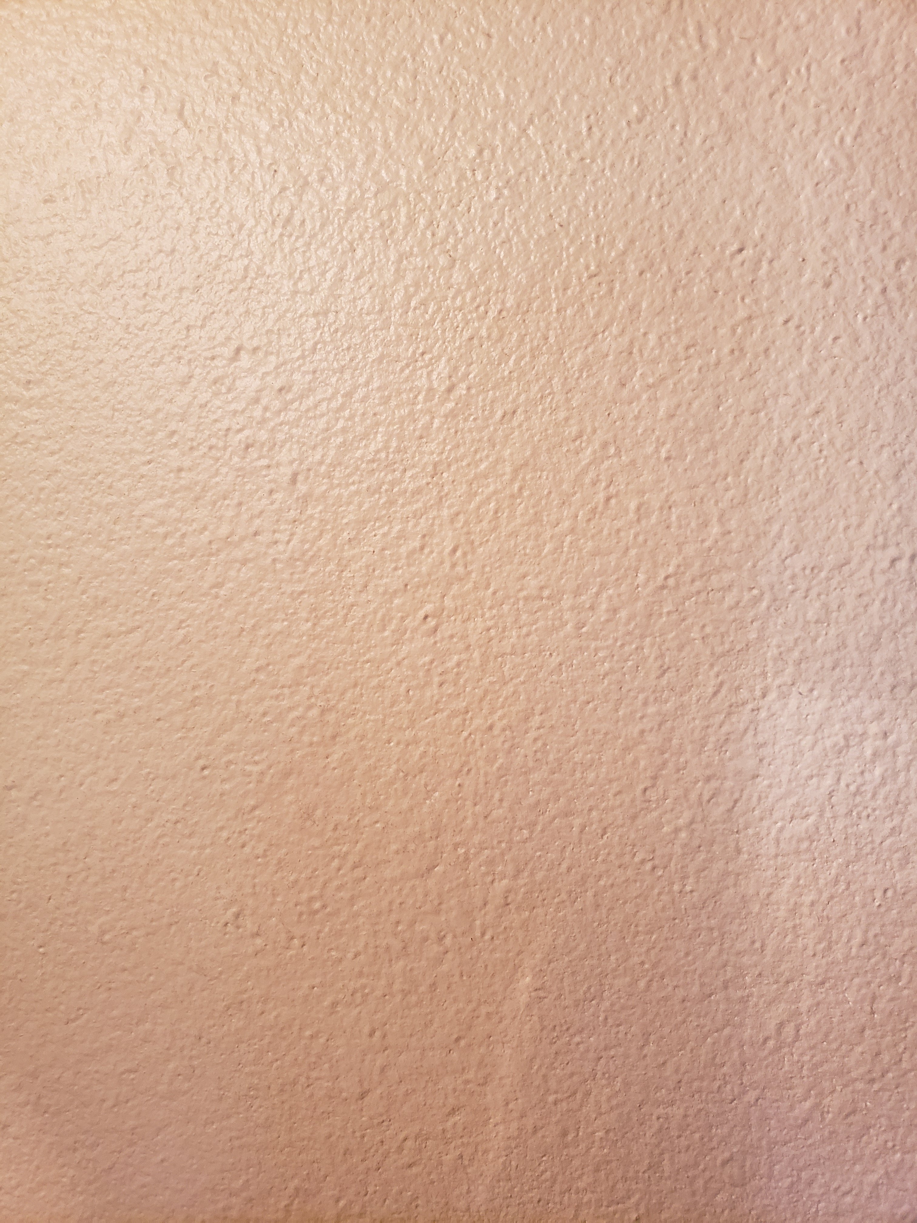

Still a little soft, had a cool front come thru, slowed the drying.
Mixed a dark peach colored paint to the drywall mud and it is drying lighter. But over all it looks great.
Three hours start to finish. Only $60.

Ha, looks close enough to stucco to satisfy my customers... Also props on delivering and a fine wall!
I could of taken a trowl to it and changed the look of the texture but this looked great and the tennant loves it. $$
