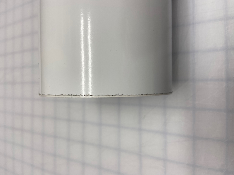

I have a roll of it and the vinyl shrinks right on the rolled liner about a 1/16in. and leaves adhesive on it before you even print it.
I usually cut a quarter inch off both sides of the material before printing on it since it could cause havoc if it gets in the print head nozzles.
