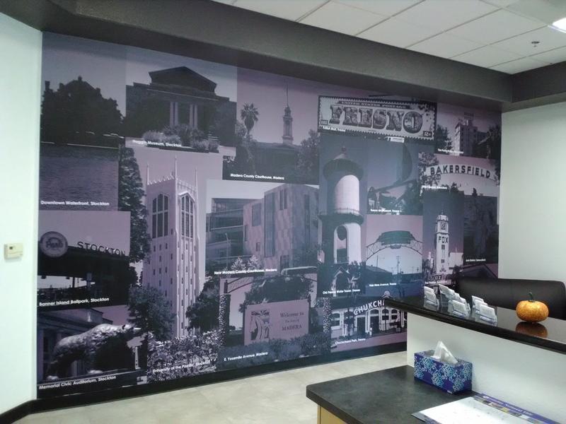

I printed a full wall mural with Avery Canvas permanent adheasive. Installed on wall texture to manufacture suggestions and cleaned. Wall paint out gassed prior to install.
Everything stuck perfect with of 5 full panels installed. Got a text a week later saying the corner panel is coming off.

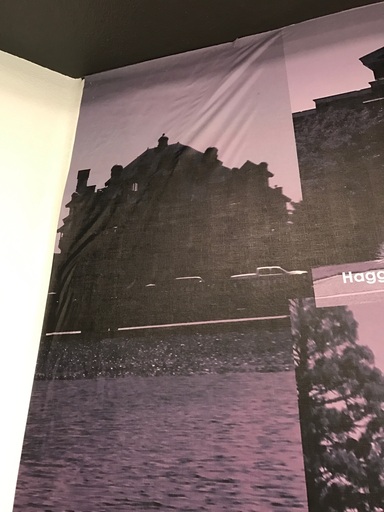

Cleaned wall with rubbing alcohol and tacked up and and secured with high tac hemming tape.
Still failed and started to peal off.
Thought maybe it was a bad roll since I started a new roll with the other 4 panels (all the ones that stuck)
So I started over and printed a new panel from the "good" roll- It is still coming off the wall!
I am stumped. The wall had the same paint and it was a build out and everything was painted the time.
Pealing panel is on the starting point of the wall; I'm wondering if the painter did not stir the paint enough when painting that area which cause a bad 3ft x 8ft patch~!! Grasping for straws or anyone had this same issue?
All my other panels are beautiful!!
