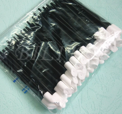

Codes from Mimaki:
cleaning stick (SPC-0527) or nozzle swab(SPC-0421)
