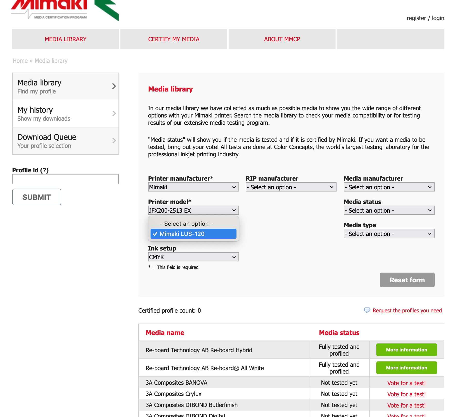

We just installed a Mimaki JFX200-2513EX flatbed and I'm finding that Rasterlink 6 is not great. Our vendor made us a 600x600 calibrated profile that is good for most of our work, but I want to offer lower and higher resolution capabilities and right now, the color doesn't match. While I can probably get them out to make more profiles, I like to have control over my capabilities as we regularly push the limits of our tools. In Rasterlink, profiling requires a $3,000 software package, plus a meter. At that point, we may as well get a better RIP that supports profiling directly.
