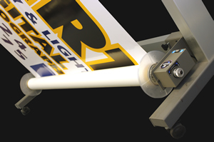

phototec

Is this takeup pretty universal or is it pretty specific to the Roland printers? I'm looking at it and wondering if it can be adapted to the Epson GS6000. That printer has literally the worst takeup system I've ever seen, I'd happily spend whatever cash I had to to get rid of it...

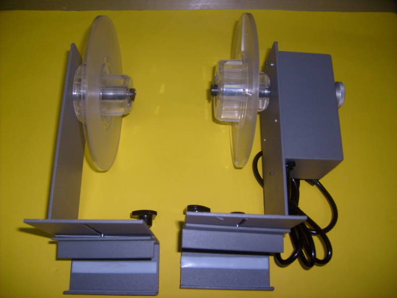

This take-up system is pretty universal, fits many wide format printers that have a similar cross brace between the legs, (see photo), not sure if it will work on your printer. But I have read a post on here a while back about someone who did some minor modifications to the mounting bracket to make one work on his printer.
You could always add a tubular brace of the correct size between the legs on your printer to mount this take up device. My horizontal brace measures 2" thick x 4" high, you use your own 3"core tubes cut to length for the take up spools.

These 3rd party T/U reels are a bit of a mystery. I have come across three different ones now, and they all look the same, but re-badged.
There's the "ReelPro" from Supply55........
The "WindUp" from England.......
...and the one I got included with my printer (no name on it).
They likely all come out of the same Chinese factory.
I'd say that they are the way to go however over the Roland one. The Roland Take-Up is a better unit; it uses a "dancer" system, but you still can't print & cut large (long) jobs with it either, so the $2000.00 price tag doesn't make sense.

Does anyone know how they wind up at the same speed of the printer.
For instance, if I run different profiles, the printer runs at
different speeds... how does the takeup know it ?
Colin
It's a simple "tension", not a speed. The tension is adjustable so you can set it to pull gently or more robustly.
You cannot use it for a print & cut job.
Yep, I did much research and figured that they all are made in China, but they are branded differently for different retailers, the main difference is in the cost of the mark-up (profit) for the dealer.
I think in this case, paying more will not get you a better Take-Up device, since they are made in a China factory. If you feel better paying more and want to support the middle man, then go ahead.
