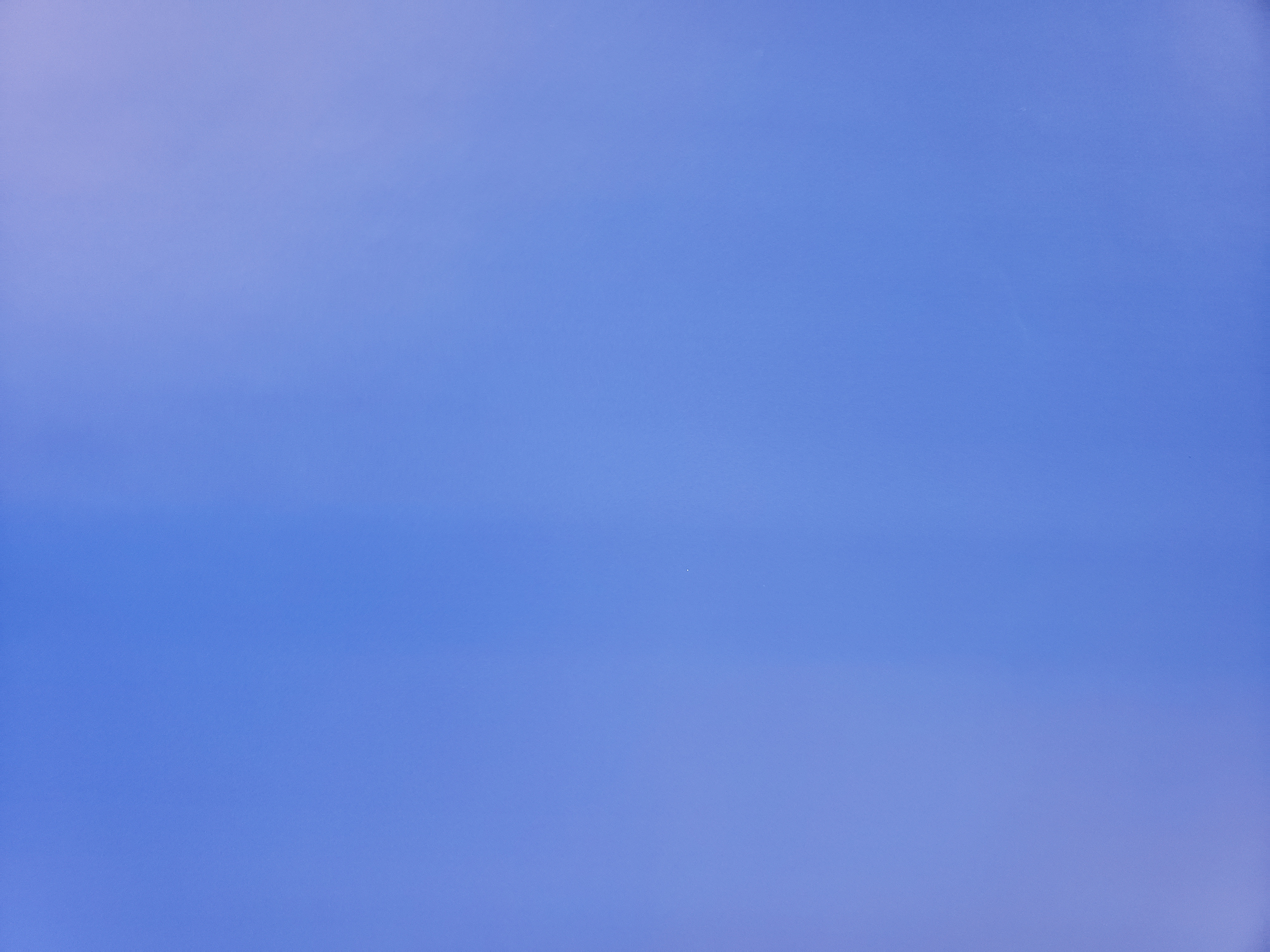

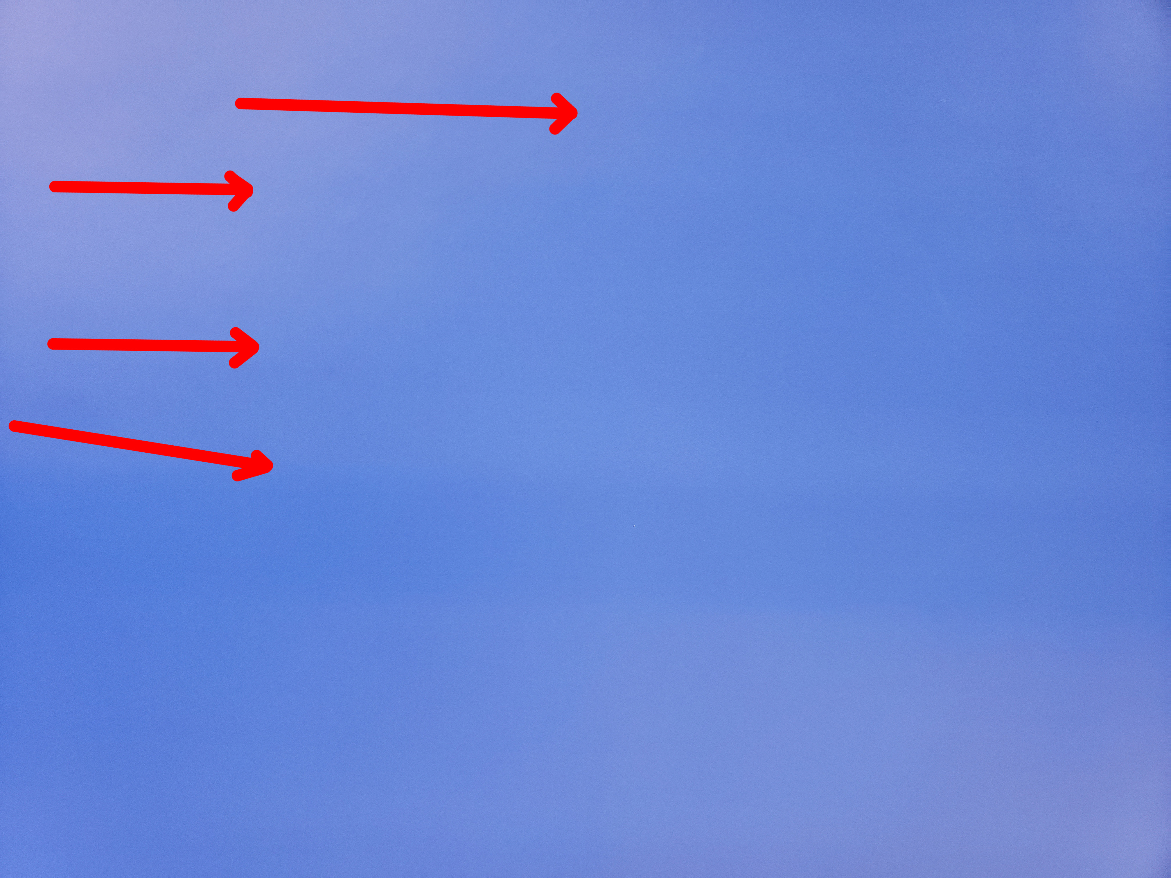

Our AGFA hybrid-flatbed has developed a problem that has stumped us and our technicians, so I'm turning to here for any extra advice. Please see the photos attached. It is subtle to see in the photos, but is more prominent in person.
As you can see, there is a streaking and/or absence of color, typically in printing solid blues, greys and white ink. We have printed in a plethora of available resolutions and modes.
All our testings have included these print settings:
Resolution: 720x1080, 720x1440 and 720x720
Machine setting: Color, and Color + White
Carriage speeds: 3, 4, and 5
UV Power: 40 through 80
Bi-directional and Uni-directional
Quality setting and Gradient iteration
The techs have swapped out the heads and realigned. Replaced ink filters. Replaced the data cable. Swapped power supplies. Check voltages going to heads, tried adjusting, but all is normal. Those are the major maintenance items they've done. They probably did some other minor testing that i'm not aware of.
Our humidity is not ideal, however techs said they don't think that is the issue. Our RH levels have been in the teens, up to in the 40's. From my research, you want to be in the 40 to 60 range... anything in there is acceptable. We've installed a humidifier, but can't seem to get the room any higher than low 40's.
Thanks very much for any info!!
