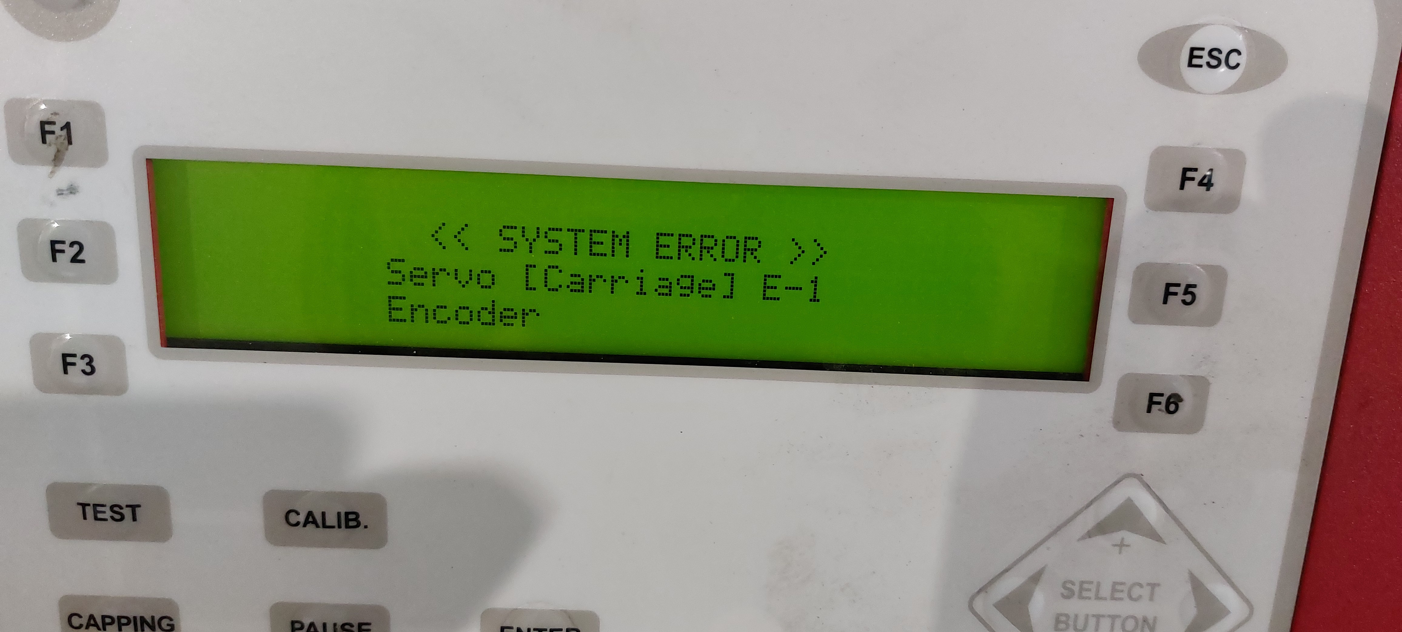

Just bought a used Anapurna MW and after installing all the connections, i am getting this error.
The motor is not engaged like it should be when powered on. The drive is also not showing any error, just displays "0". The second driver (for the feed) shows though "0.00".
Not sure where to start from as there could be many sources as encoder error: the motor encoder, the linear encoder on the carriage, wiring etc.

UPDATE: among other errors, which were popping up randomly, was also the safety sensors, in spite of them all being green LED. A colleague, playing around with a screw driver, turned about 90 degree one of two screws of a barrier sensor (8 in total), and all errors were gone: servo engaged, safety sensors cleared, machine was responding to the ping request etc.
