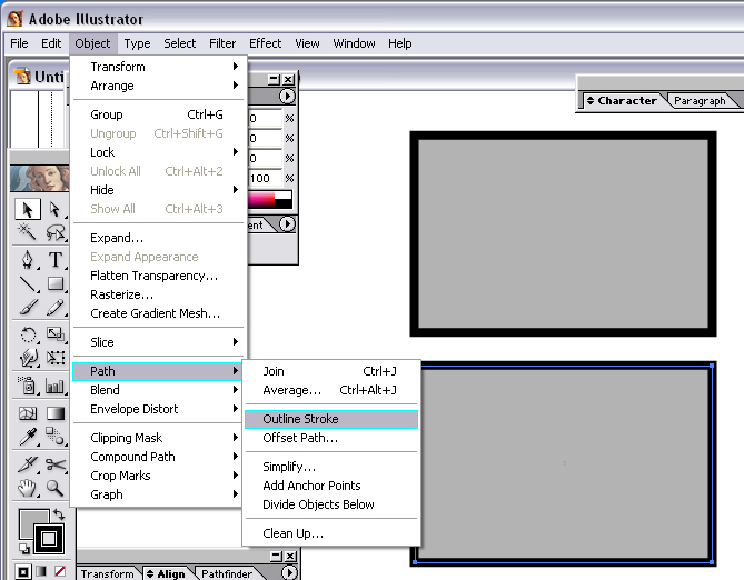

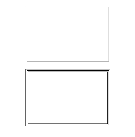

Just to be clear Bobby .... my suggestion was not to remove the strokes. It was to convert them to outlines. By doing this you end up with a vectored version of the stroke at the size it was created and with the fill that was previously assigned as a stroke.
I agree that having Illustrator is handy for reading the latest version files sent to you in AI or EPS. Being a native PostScript application, the accuracy is superb. I've always had excellent results with Flexi as well, which to me is like Illustrator on steroids.
The two pics attached show what I'm describing. #1 shows two identical boxes with gray fill and black stroked border. The lower box is selected and is about to have the Outline Stroke command applied to it. The #2 pic shows the difference in the actual vectors after the command is applied and the preview turned off.

Gotcha Fred... Must have misread your original post. Removing would thin the letter more than likely so your suggestion of converting to outlines is correct.
