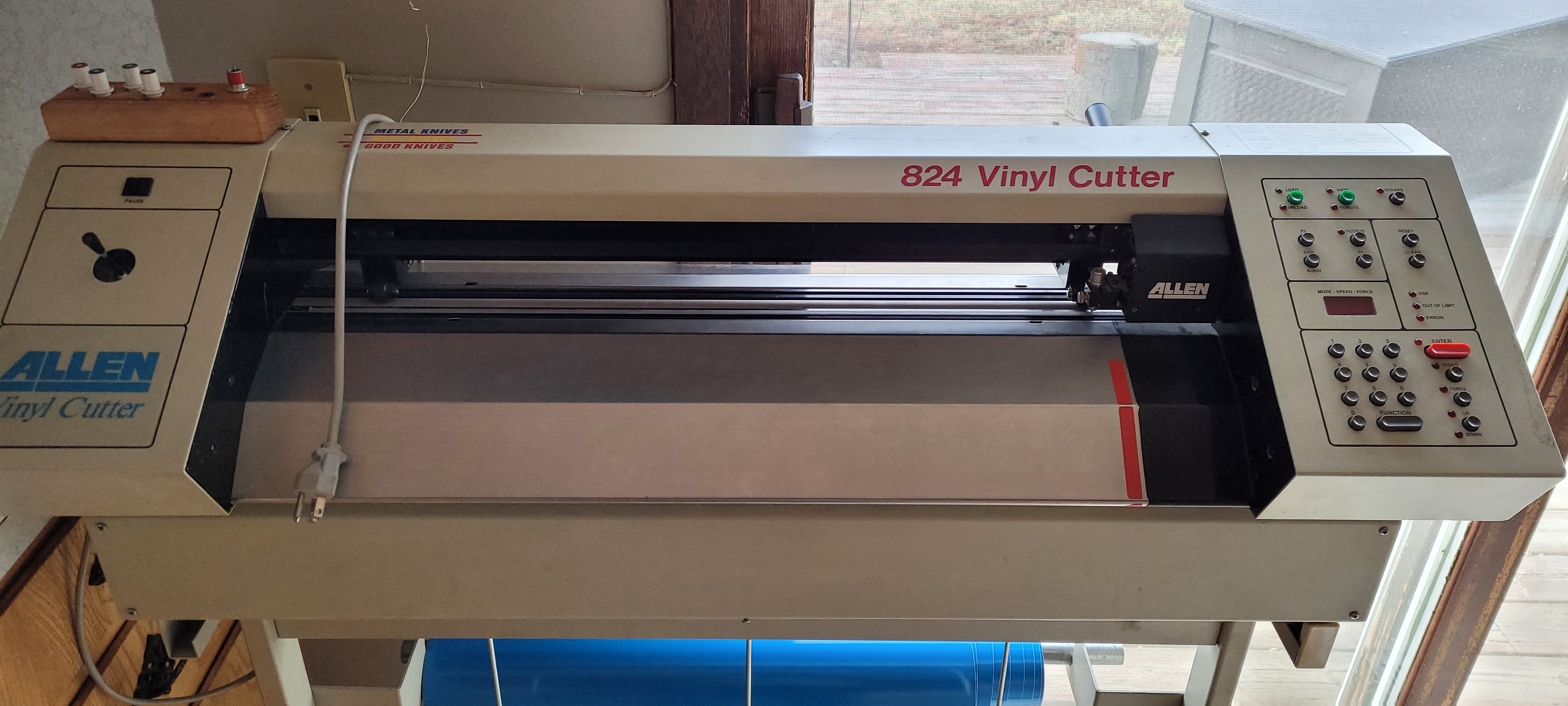

I have an old allen datagraph 824 and I used it awhile back and had it in storage for a bit yesterday went to cutt some stuff and when I turn it on I get a e03 code and a d21 and I have no control all I can do really is function function clear for soft reboot. Has anyone had this same problem and is there a fix to this ?
