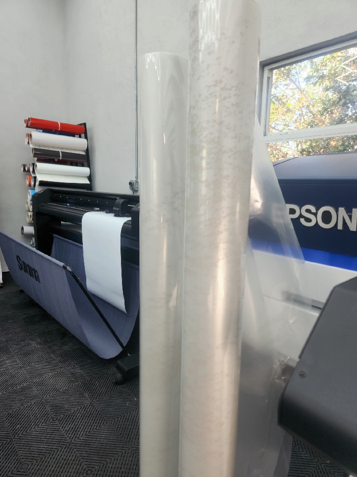

Hi,
I have been having issues with 3m for the last two years, the quality has gone down & price has gone up!
The last 20 rolls of lamination have marks in them half way though the roll (most of it comes out with heat), & IJ180 doesn't seem to stay in contours as well.
I have tried Avery in the past, but doesn't leave a clean removal 5 years later like 3m.
Allot of shops are switching to Brightline by grimco, apparently its basically arlon. (I haven't used it)
any recommendations?

To be honest, I think all mfg have had some quality-control issues since Covid. The only bug I have with the 8518 is on the last 10ft of the roll (dull spots that disappear with heat). My trouble comes from the IJ180mC-10. I'm printing with a Roland VG2-540 (OEM inks) and on solid colors (which I print a lot) there's spots/sponge pattern/contaminants-like effects that is not acceptable for my standards. When printing on any other 3M films of this serie (ij180-114 clear, SLS for stainless tanker, LSE for hitack) everything comes out PERFECT. Regular white 180 is crap here on my printer (and all my ink pouches are stamped 3M MCS Warranty (...)
After trying about every other films on the market, my very best combo for the jobs I do here (mostly semi truck graphics) is Oracal 3751GPS + 3M 8518. Arlon offer some very nice films too, prices are very good but nothing beats the clarity and gloss of the 8518. I'm a long-time Oracal user (2004) but as soon as I tried the 8518 I was sold. Side-by-side comparison of 3M's vs. the other will proove my point. Print a vivid blue patch and try 'em you'll notice how minimal the 8518 shift the color and gloss level is second to none. The worst being the Oracal 290G/GF.

Old thread but I’d figure I’d add my name to the list of people getting bad 8518. Last 10 feet of so on the roll is all blotchy. Basically useless.
