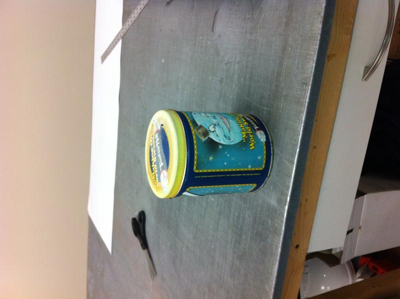

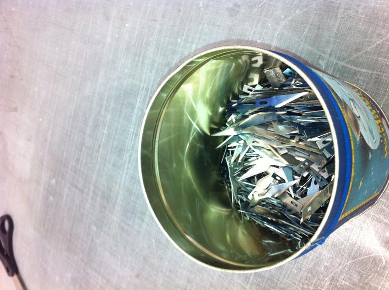

d fleming
I have sixteen year old galvanized tops on my interior work tables. Still working great. Nice that magnetic sheeting sticks to it also. These things have taken a serious pounding over the years. Before you say it, x-acto blades are cheap. I've been filling this can a long time, lol.

d fleming
Our tables are similar, but aluminum and I hate them. Anytime we put together banners on the tables it leave black aluminum grit smudges on the back and
you can't a print across the surface, it too rough from the cut marks, it would scrape up the print.
My favorite table worktop is 1/2" mdo board or sintra, painted with a heavy enamel or oil base paint.. Every couple of months, when
they start looking rough, recoat them on a Friday afternoon, It only takes 20- 30 minutes and Monday morning you have a slick, glossy, new table top.....
That would make it a spoil board, lol. Marble saw board has to be re-mortared about once a month for same reason.
