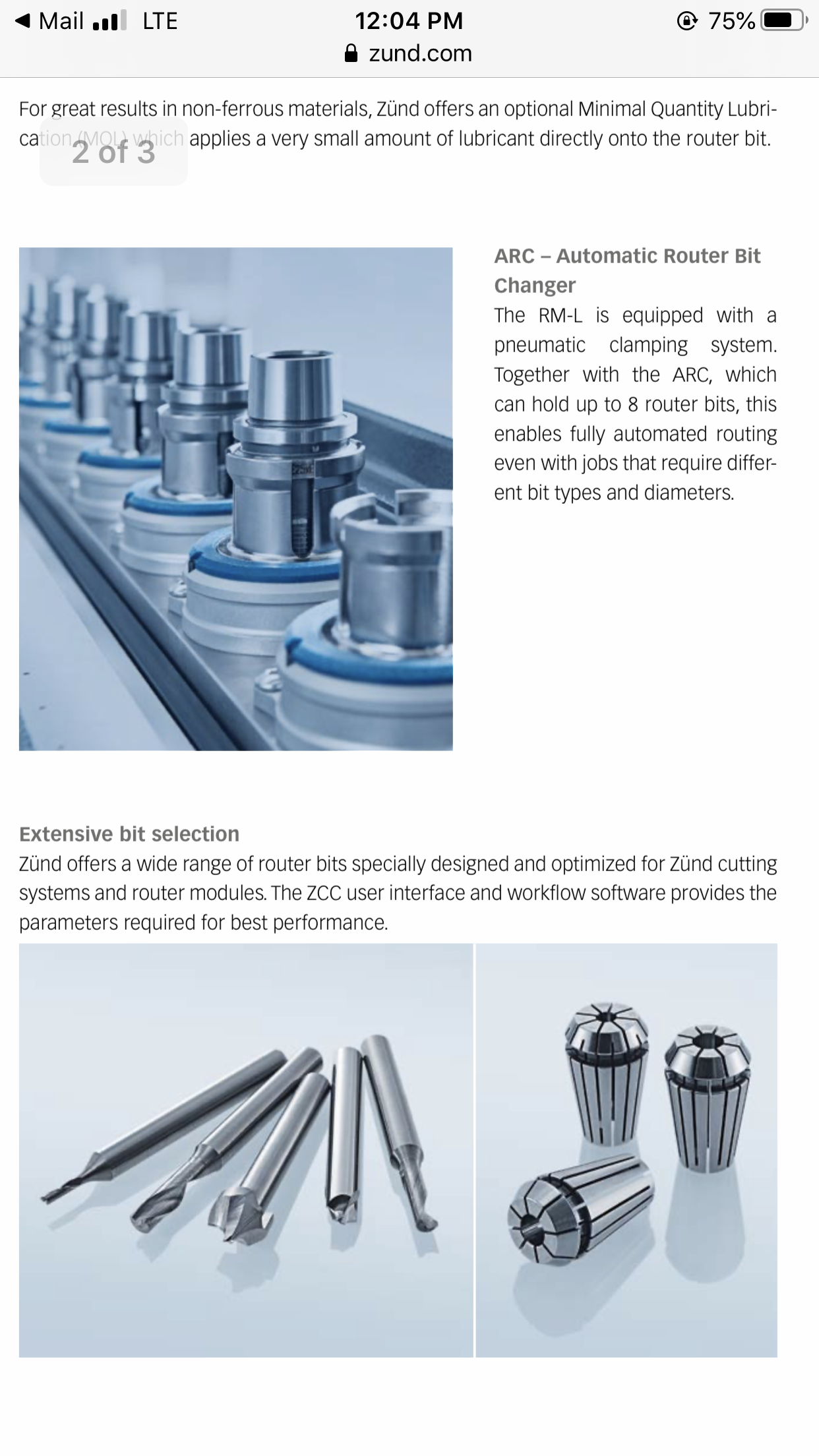

They look like this.
What router module did you get? The 3.6 does not require that collar. It looks like this...
We just did the upgrade for the 1kw Router. I wanted the 3.6 for that very purpose but it was almost double to do the upgrade to the 3.6kw because of all the changes that need to happen.
