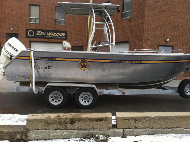

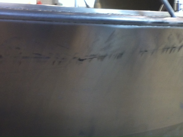

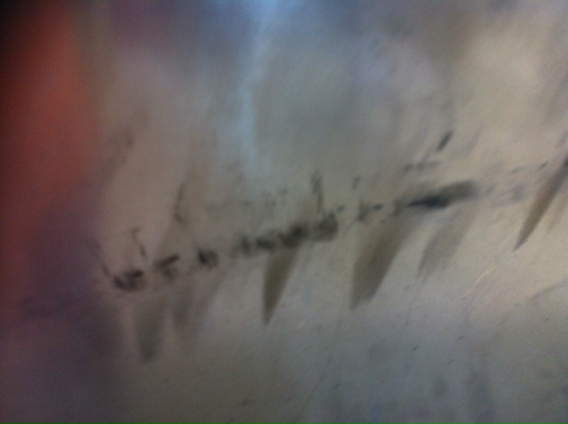

I am posting 3 pics...the first is a boat we just finished for the Ministry of the Environment and even though you see this strange discoloring in the pic it was not as bad as the next 2 pics which I am working on now.
I thought it was just tar or rubber from rubbing up against a dock, but the boat is new!!
I cant seem to get this stuff off...even tried a little laquer thinner but it seems to be in the finish. I suppose I can stripe it up right over it, but this boat is brand new. How can they sell it like that? Oh right government!!! forgot.
In any case any ideas how this stuff is removed and using what?

Raw aluminum will discolor like that. Greasy handprints will also show, that's what it looks like in the last photo. It is in the aluminum since aluminum is somewhat porous, you can try a little acetone to see if some of it will come out or even Bon Ami (though the finish will show the scratches). The only other thing you can do is polish the entire boat... not something they'll want to pay for, I'm sure.

Yep. It's the oil they use in the manufacturing that's embedded into the aluminum. It's used to keep the alloy from sticking when it's rolled into the coils. Lacquer thinner just spreads it around - you have to degrease the metal (Simple Green works great here), then hit it with acetone. If you run a white paper towel or cloth over the area and still pick up black, it's not clean. PITA, I know... did that for years at a boat dealership!
