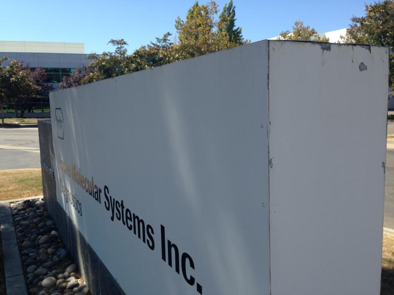

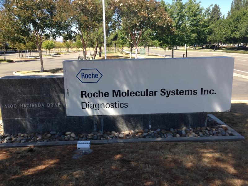

Its non eliminated. I attached a picture of the both that i looked at. First one we are to replicate. I did not see any attachments, screws or any way of opening it so have no clue how its made or how that reveal is made.
Second one we are to replace because its in bad shape but again i did not see anything i can open or close from top or bottom. this one shows screw or rivet locations where the paint chipped but everywhere else it looks like the screws were ground then painted over.

On the top sign, looks like that base was not made for that monument.
Did you try rocking it back and forth or seeing if it twisted? It may
give you a clue.
The reveal, I would clean it, and see if you see a seam. I would
have hid the attachment there. Post embedded in concrete, then
bolt through that reveal. then epoxy, silicone and/or VHB that in place.
It might be crazy but see if the top lifts up. I've done that and the top lifted
up exposing the attachment.
I would make that second sign in two sections, the bottom bolting to embedded
posts. the top sliding on the reveal, screw top on with flat heads, cover with painted
strip.
The second sign is obvious, the face and sides look like they can be removed.
Unscrew or drill out the rivets/screws. Exposed screws/rivets is the least preferred
method.
In cases where we had to refurbish a sign with hidden attachment, we
would have to saw a hole into it, and reskin later.
