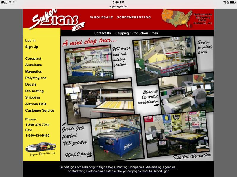

Yes call super signs in auburn, al. They will whip those things out and they will look great! They will screen them and punch holes. Shipping might suck but its a start
