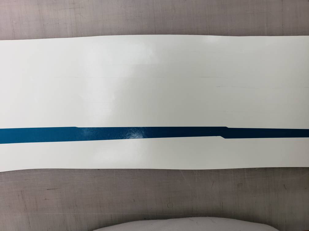

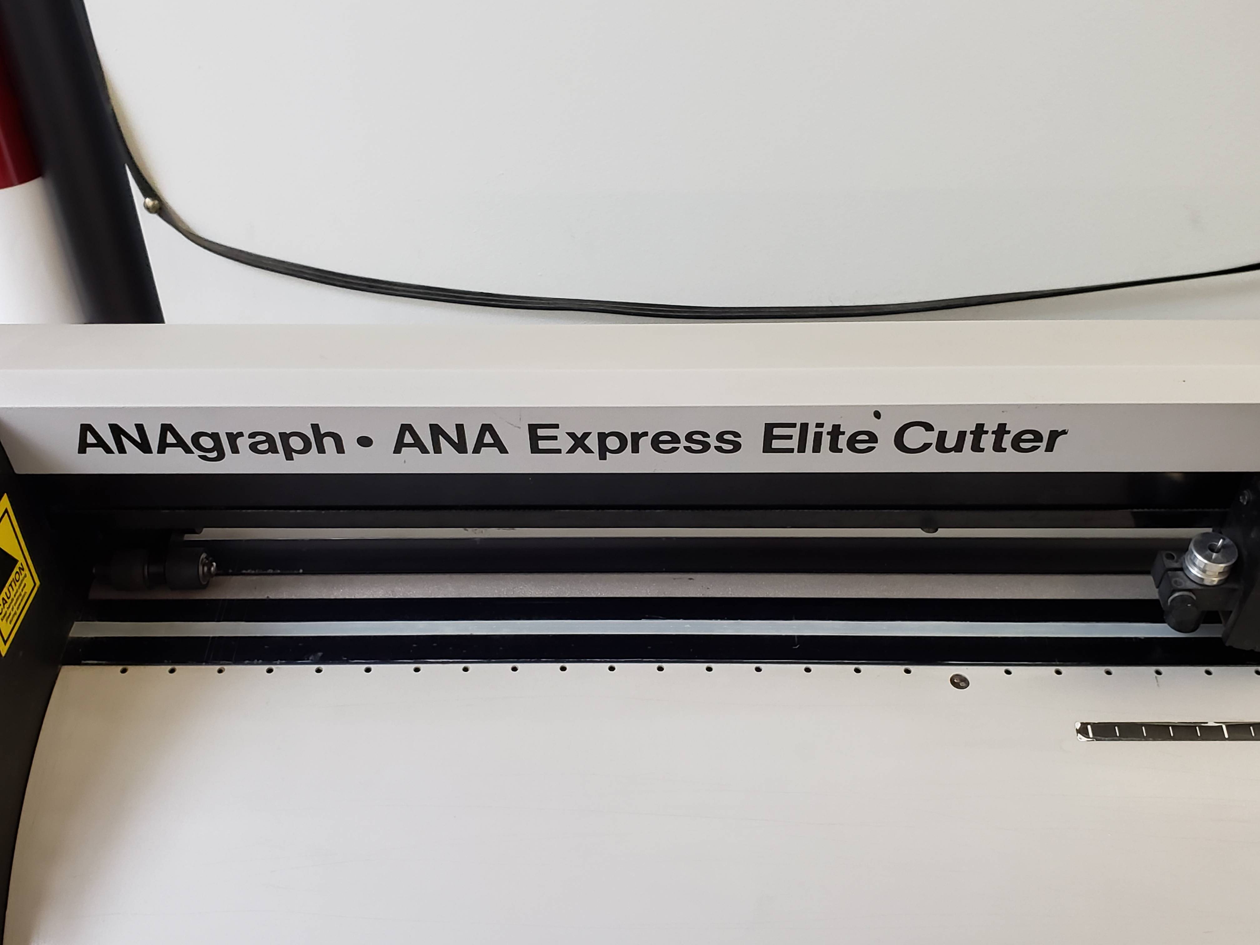

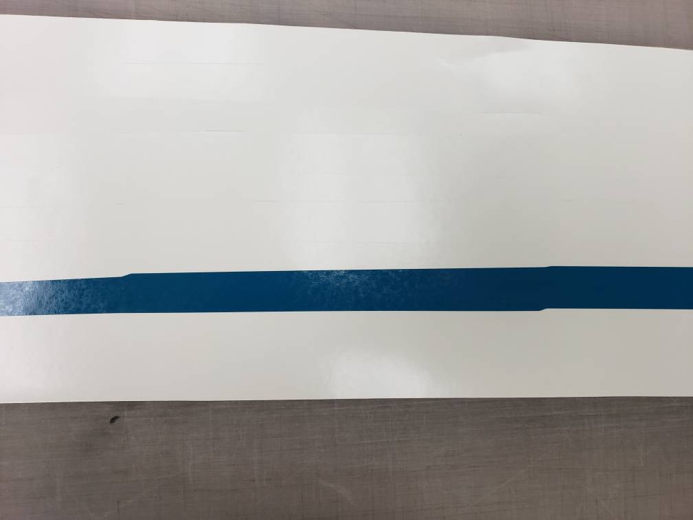

I use an old Ana plotter and it has always performed pretty much flawlessly...however...

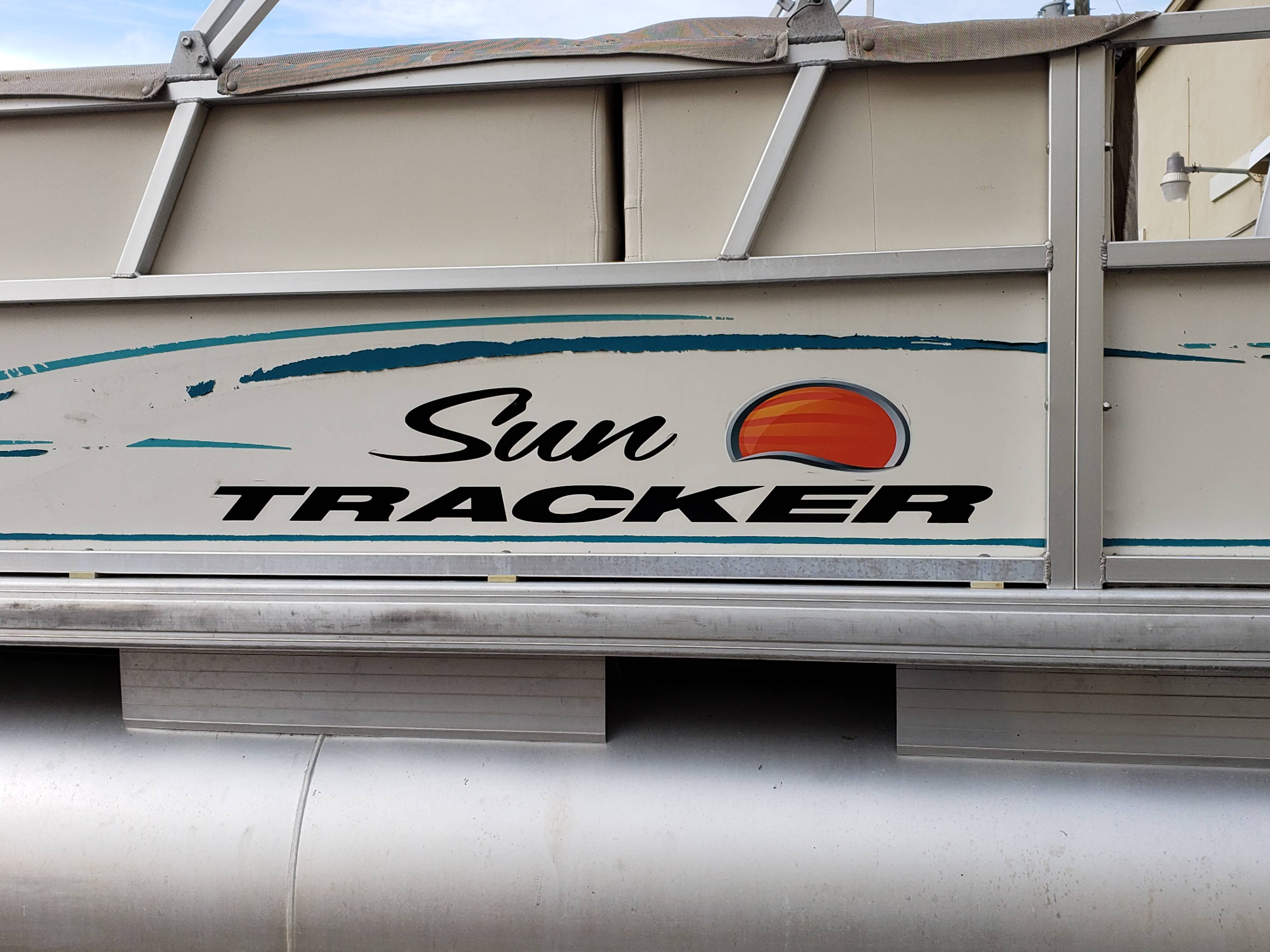

When cutting arched shapes like the ones in the pix I am posting it wants to drop or climb in "steps" as shown...
I also am posting a picture the graphic on thee boat that I am trying to reproduce...
I am not sure if this a software issue but I am hoping that it is one of the settings on the actual plotter...
Any help would be greatly appreciated...thank you!

I have experienced the same issue. It isn't your plotter, it's how the ANA software handles the arch. The odd thing is if you had an oval the same size it would cut it flawlessly. As soon as you cut a section out of the oval it distorts the file. The only way I've been able to achieve a clean arch is to superimpose two ovals over each other to form the arch and then cut them both weeding away all but the arch formed by the intersection of the two ovals. Works well but wastes lots of vinyl.
