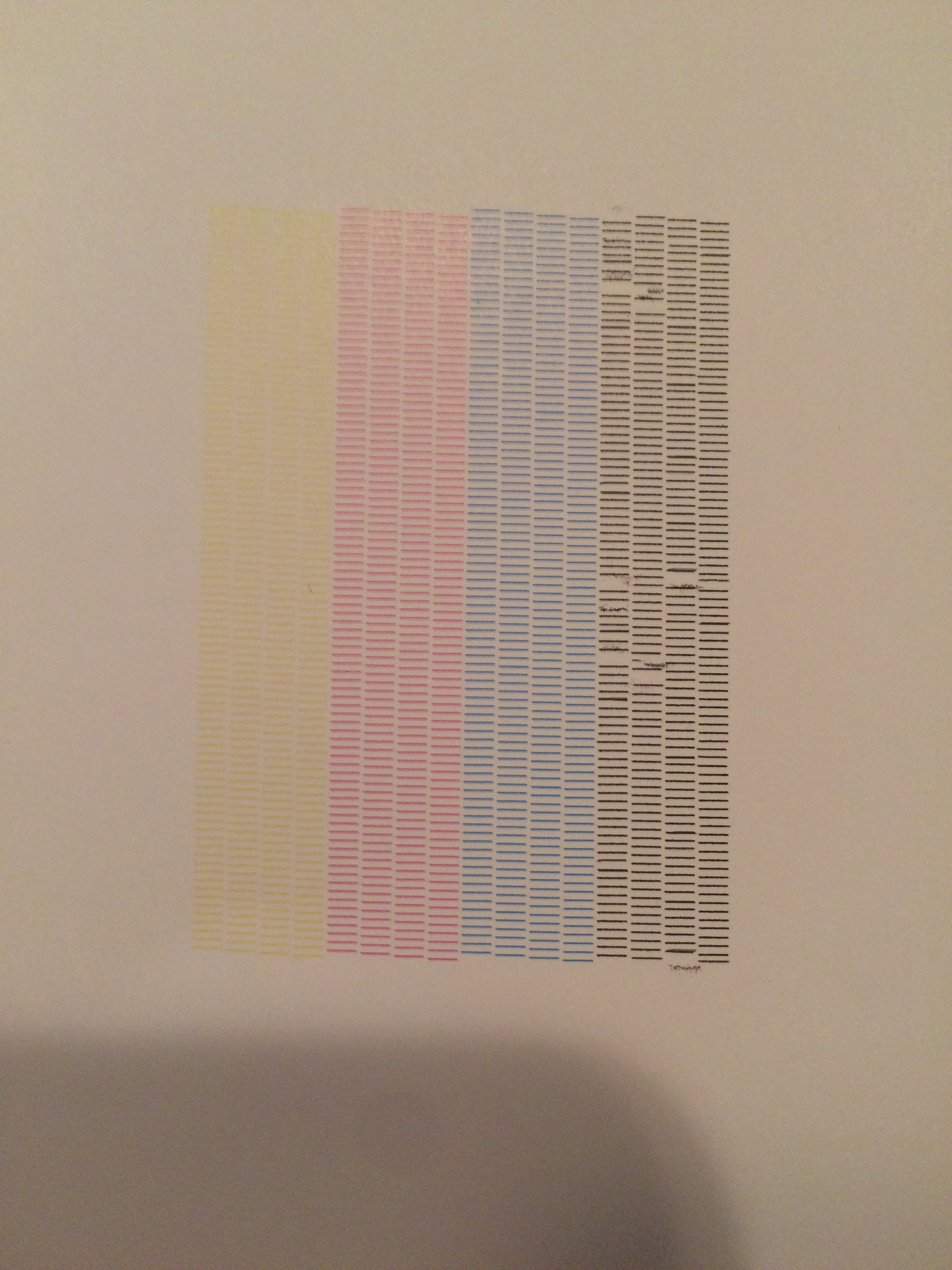

hi all,
I tried searching test print pattern analysis etc but couldn't find an answer. Probably due to how I was phrasing it. Anyway, my black pattern looks funky. I did powerful clean as well as clean heads etc (yeah I did touch heads themselves with solution and swab but thankfully I don't think I made it worse. Attached is a photo. Thought advice or direction is greatly appreciated.
CanuckSigns
it doesn't look horrible. does it show up under normal printing conditions, i.e. can you tell these is an issue on your prints?
You can try soaking the head in cleaning fluid, if that doesn't work and it's affecting your output you may need a new head.

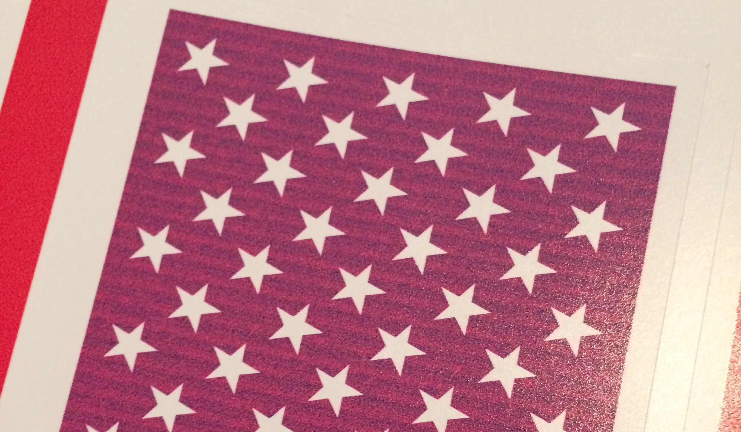

Thank you for the very fast response! I assumed it was the problem when I printed some American flags for a local fire dept. (Photo attached)
And although I'm a bomb tech fir my day job, I'm afraid of taking off the head as I've never done it before
CanuckSigns
that print looks worse than I expected given you are only missing 8-9 nozzles. Try running in high quality mode, it may help lessen the issue.
If you are not comfortable replacing the head, i would suggest contacting a roland dealer in your area to do it for you, but expect to pay about $2-3k for it.
Alternatively, there are a few merchant members on this site who can sell you the head and offer you step by step help over the phone to walk you through it, if you are used to disarming bombs, i'm sure you can handle changing a print head!
