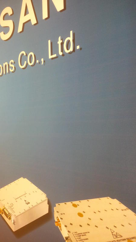

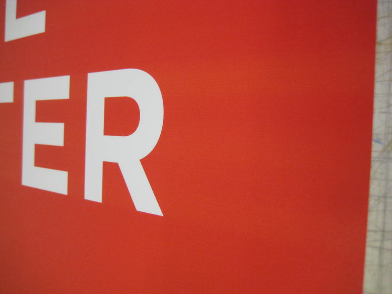

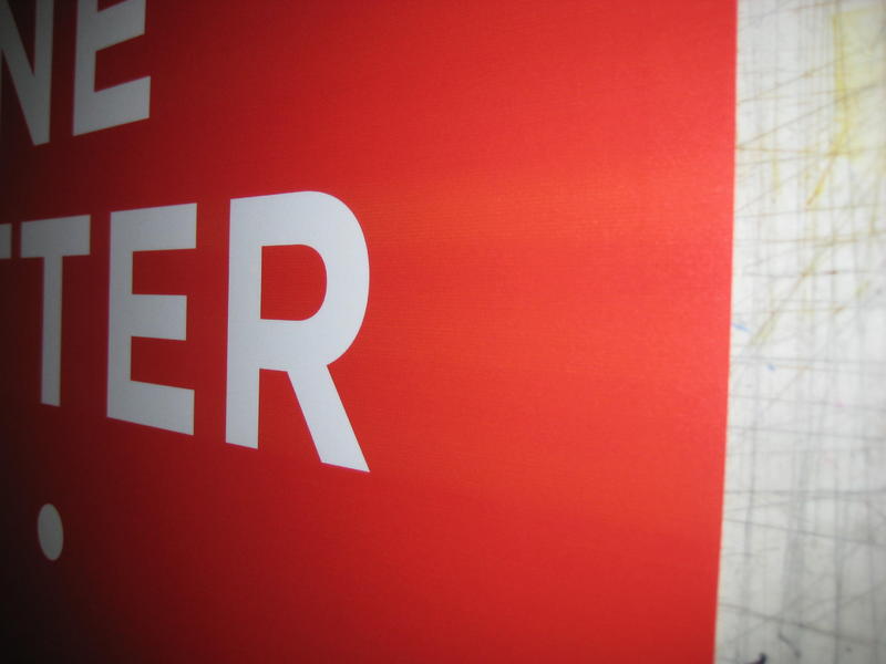

When running out a full tint, I do not get a reliable flat colour ...
Where the tint is broken by text - ie on the red image - you can see the red runs slightly lighter.
On other prints I get 'stripes' through what is meant to be a uniform flat tint ... only very subtle - but you can see them.

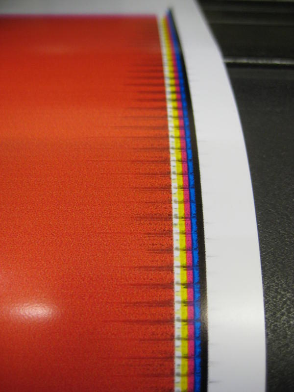

At the same time the colour bar 'tram line' shows marking at the sides of the media as the carraige comes out of the docking station, these marks appear only on 1500mm media, this does not occur on 914mm medias, I have tried this with the 'wipers' box removed, and cannot see anything that would be physically touching the media.
I would say the last image is your print heading 'scraping' the media as it passes over, maybe a media feed issue?
Most solvent printers I've worked with require a well dialed in profile for solid grays or blues to print perfectly.

Now it is winter, the issue with the last image seems to have gone (black streaks in the tram lines).

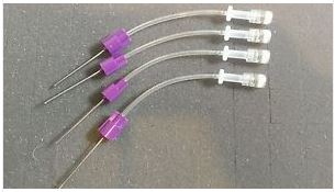

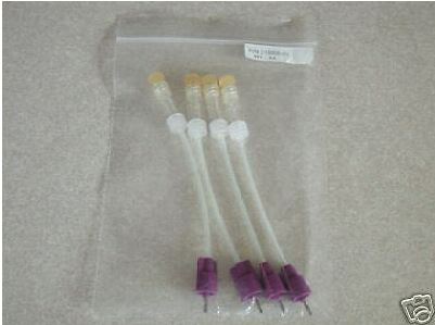

I am wondering if it is a 'prime' issue - ie poor prime - low pressure in the lines, we are going to replace the cartridge septums, I see we can buy longer stem septums than what we presently have - anyone know what the difference is - between short and long stemmed septums:
