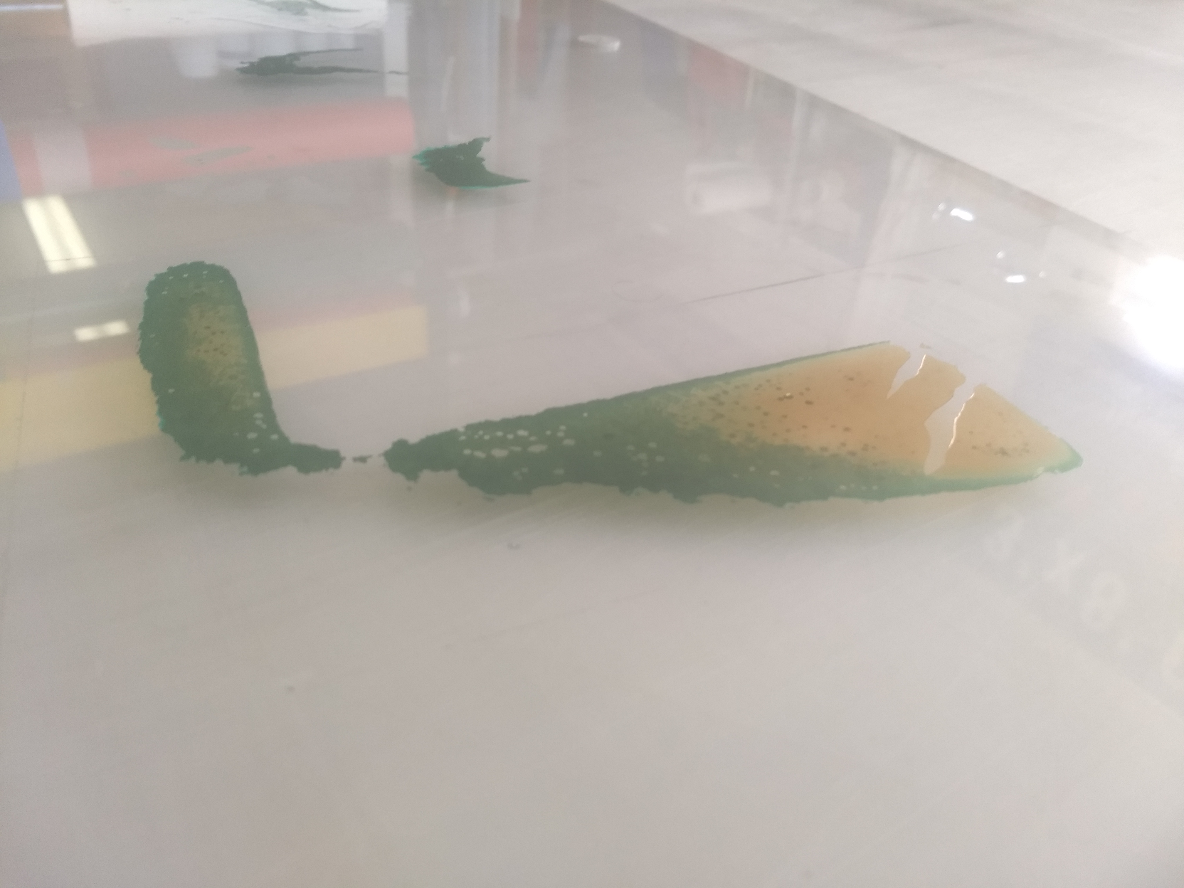

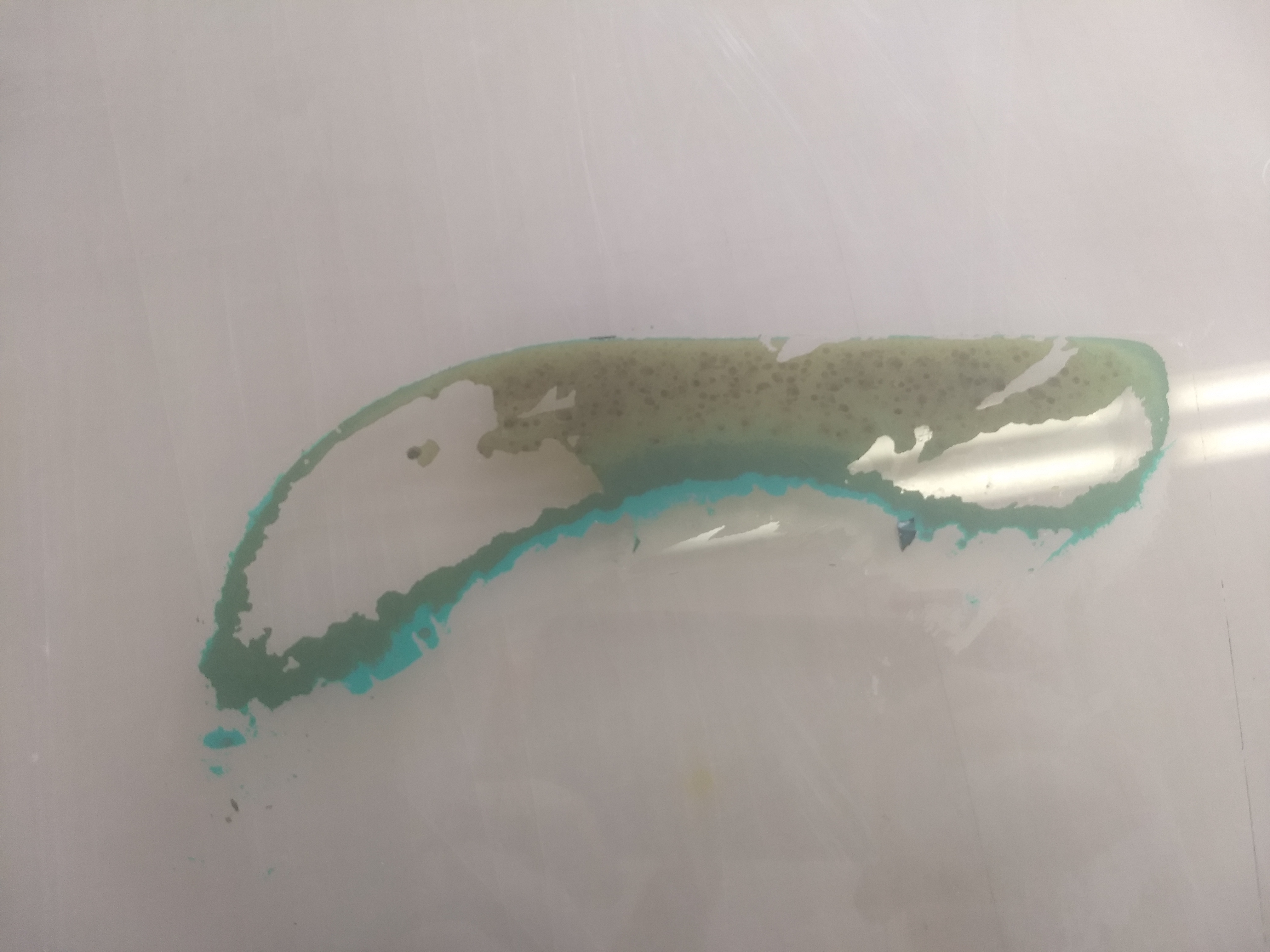

I've got a 3/4in clear acrylic panel that had second surface translucent vinyl. The customer brought this one in to get redone because the letters were coming off. We didn't make the originals and they don't remember when they signs were made.
Issue: This green flaky stuff that is baked onto the acrylic. Originally thought it was a mold or mildew, but it appears to be prat of the vinyl. We can obviously scrape it off, but even with a new blade and lubricant, it still scratches. Soaking with rapid remover, alcohol, or soapy water had no apparent effect.

you will have to sand it off or use a removal wheel and then buff the surface smooth again.
have seen this before with low grade that is left way too long in the sun

Yeah, we removed the original letters with heat. I didn't want to buff, but it looks like we'll have to. Sent the customer an update and they said "use another side."

No, it's mounted on stand offs in front of a brick wall. Second surface vinyl. For some reason they used translucent vinyl even though it's front lit.
After multiple confirmations, we'll be applying first surface and they said they'll handle cleaning the back.
Okay, never mind. Just got off the phone. What a nightmare. Sand and Buff time.

Try some 600 wet and dry sandpaper to get it off then 1000 grit wet and dry, compound, and then polish, will look fine and not even know it was there.
bannertime
I think that's what we're going to do. You think we'll need to do the whole side or spot buffing will work? I'm not sure how much distortion would be visible on a panel this thick. Don't typically work with clear.
Johnny Best
Just where the spots are should be fine, you could go over the whole thing was some plastic polish just to make it pretty.
But since it is on the back side you won't notice where you did it. I have a large polishing wheel on an electric motor and with two people holding a 3x5x.75" piece could buff that out quick.
