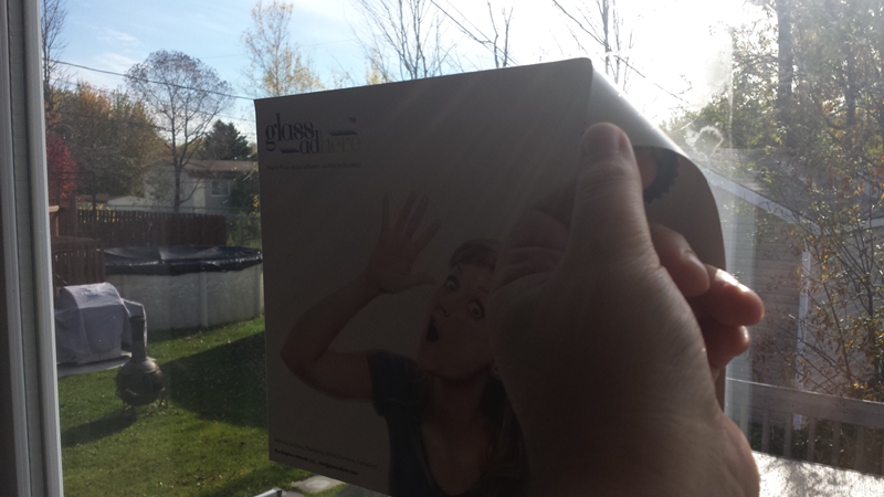

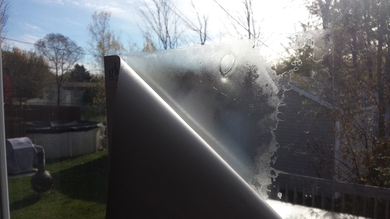

Be careful with the glassadhere. I had a sample on my window for about 90 day and when I removed it, it had leave all the ''glue'' on the window. I've already contact walter about the subject and he said they will have a new version within the next 30 days. Can't wait to try the new version.
