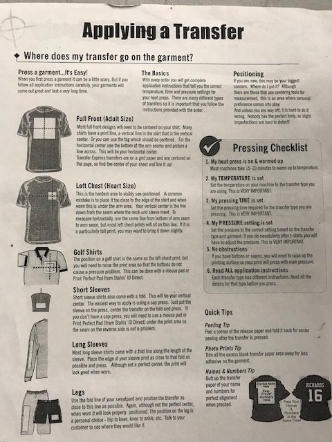

using this info i just made my own template - i've seen templates on ebay cheap but the plastic gets soft plus the learning curve of burnt knuckles touching the heat platen ( one learns quick )

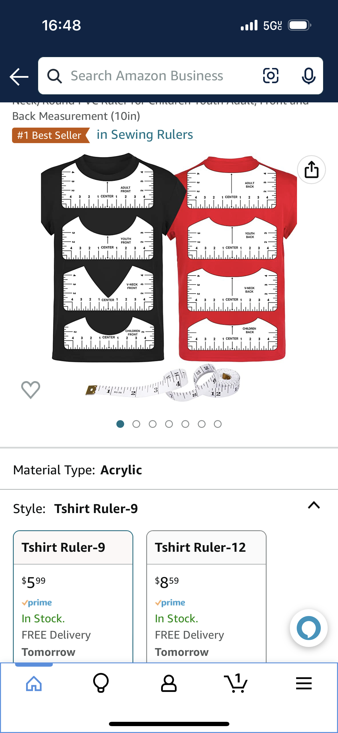

I bought something called a t shirt ruler from Amazon, for a small project, as I usually don’t do garments. There’s a variety and cheap.
