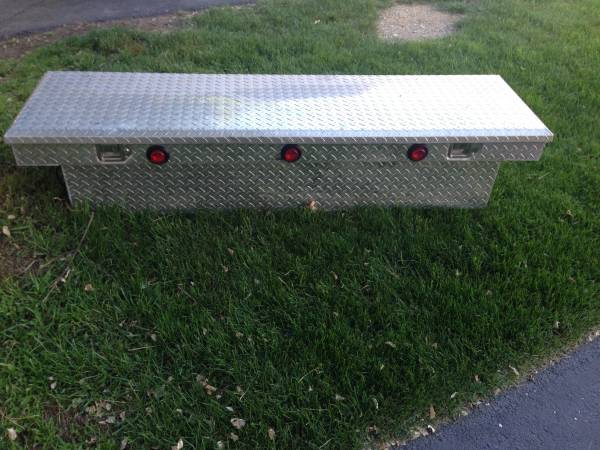

Anyone ever wrap a toolbox for the back of a pickup?
Tony Rome
Just wondering, I was thinking of getting one, but want to wrap it.
I know they make smooth ones, what would you think the chances the one (like shown) would be like to wrap with that pattern that is on it?
If vinyl goes down...does it stay down?
Any experience?
Thanks!
Tony Rome
480Cv3 would work on that, long term durability would be suspect though if being used as a functional toolbox.
OK, well I have some of that so I will try it just wasn't sure how easy it would apply over that pattern, I guess a little heat would do the trick or maybe have to bust out the rivet roller?
Thanks
TXFB.INS
+1 for the roller and go with the pattern.
if its a functioning box, then be ready for the abuse
TXFB.INS
if it is a working tool box, 9/10 times they (customer) is not gentle with loading/unloading the content and the graphics will take the abuse.
Make sure the edges are sealed as we usually see that failing first since content is dragged in/out of the box
Tony Rome
Oh, good news, it's for me.
