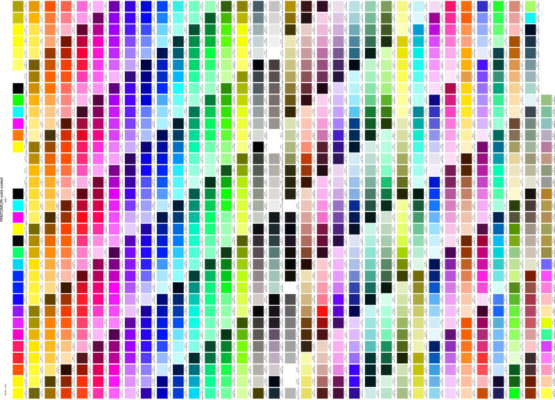

Bretbyron
I think I exported this one in CMYK @ 300 dpi 50%. When printed at 200% it is 42" X 30". Some of the long names overlap, but are still readable.
Note: Made it in Corel and it says JV33 in the top left.
Let me know if you want me to send it in an editable format.
Hope it helps.
attachment.php
