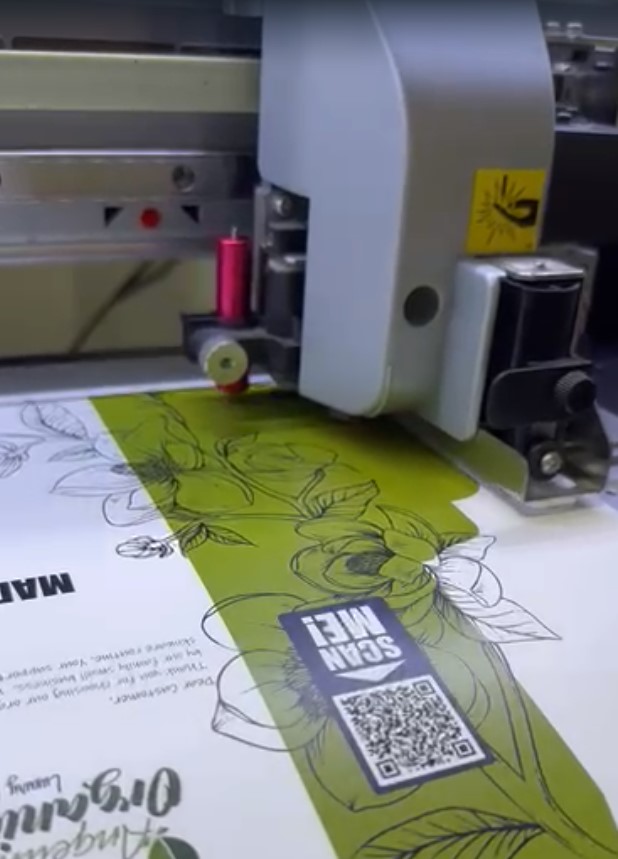

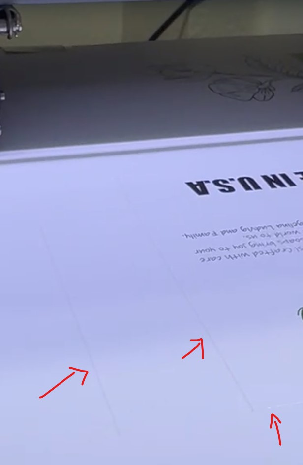

gludvig
Hello guys,

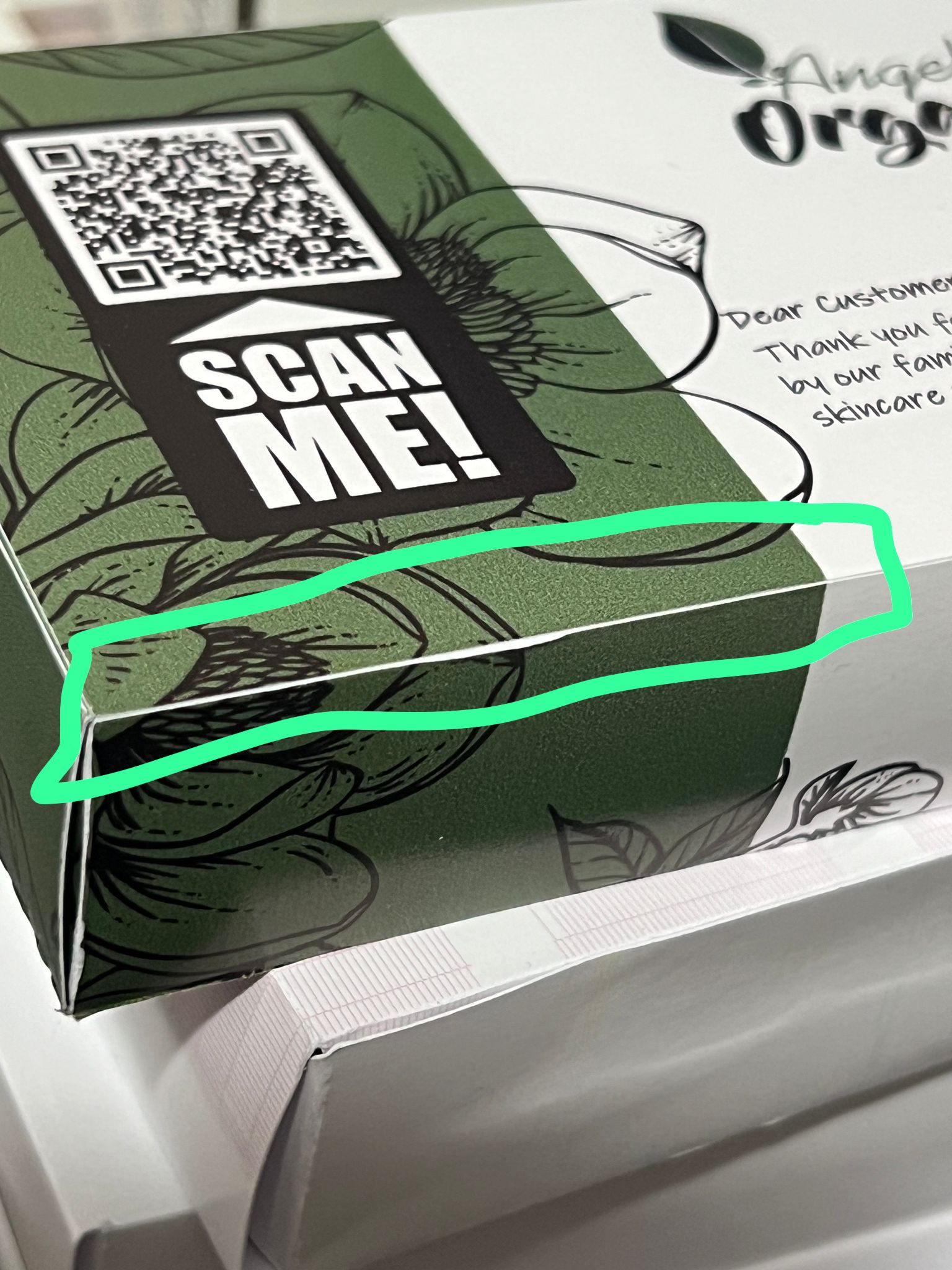

Sorry about the question, but what do you guys use the creasing tool for the most ? I'm working with small custom boxes. but I just started and I'm looking for something that can crease, I use my Mimaki CVJ30-100 to print, I'm using the blade tool to kind lets say "Crease" It works, BUTTT, you can feel that the corners are cut, on the fold, the creasing toll look like it does a way better job and not cutting the paper on the fold, but kind smashing the paper on the fold.
I'm trying to get more details on what kind of material to use the creasing plotter, did any of you try using the PEN tool to see if it can do the same as the creasing tool ?
I see people using this Mimaki CG-60AR, but its 1 by 1, 1 item at the time, I guess it can work with roll paper instead paper sheet right ?
Thank you guys.

You can buy just the creasing tool from Mimaki, or get a Roland style one and use that.
gludvig
The Mimaki one would be the creasing tool for CG-60AR ? This is the only creasing tool I found for Mimaki version. I see the one for the Roland style, it looks good, I'll get this for Roland and try it out.
THANK YOUUUUUU guys.

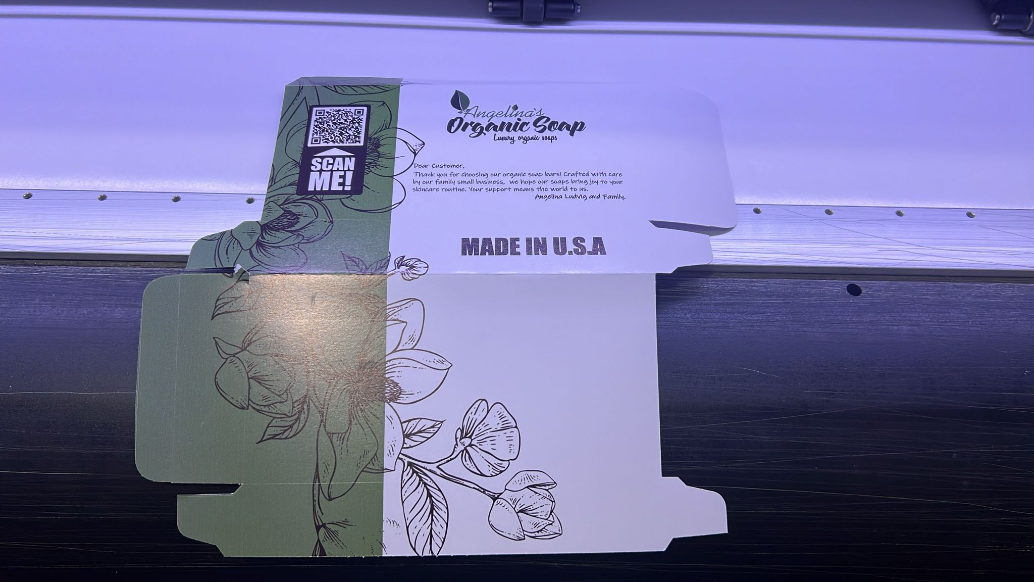

gludvig
Happy New Year to everyone,

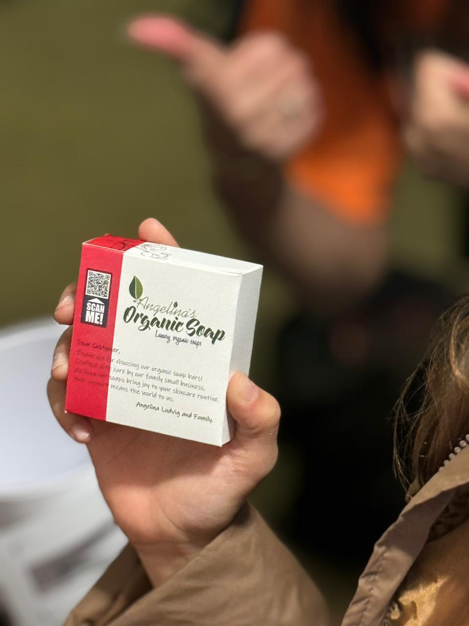

Thank you all for the tips and information provided here, It worked as "Smoke_Jaguar" mentioned above, I got the creasing tool from Roland brand and some from china to try, all worked great.

Looks great, what kind of cardstock are you using and is it roll or sheet form? Been looking for a good cardstock roll paper for my UCJV300 and looks like you got that down.
Hey, I used poster boards from Walmart, but they are not suitable for printing on a Mimaki printer. It's not the printer's fault; rather, the paper is not treated to receive liquid ink. Consequently, I had to print on a laser printer.
I use the SIHL TriSolvent Premium paper 200gr 8Mil semiGloss from Grimco "https://grimco.com/Catalog/Product/IM0130" store, BUT it's not the ideal one, it's lil thin, I'm looking for a ticker around 230gr with 10Mil, I think it will be thick enough for custom boxes jobs.

Yeah, at that weight, might be better suited to small boxes under 2-3" cubed before it gets kind of floppy. That said, I like Sihl media, use it when people want crazy high detail/color stickers and I use an Epson 9900. Water based inks and sticker media, a rare combination. Expensive, but looks amazing and their stuff tends to be very consistent.
