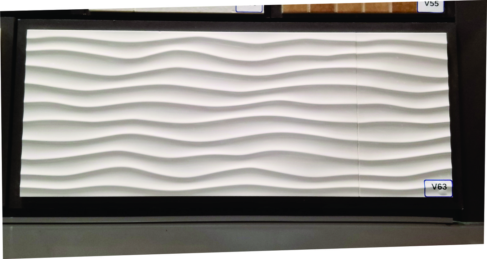

Interior office wall - wants to install lettering and logo on this surface. Looks like job I don't want or is it no problem? There are 12 letters 12" to 18" high plus a rectangular word panel 6" x 45". Naturally the letters would be stud mounted. Not sure about drilling in to this material (ceramic according to spec sheet). Anyone have any experience with this material? TIA

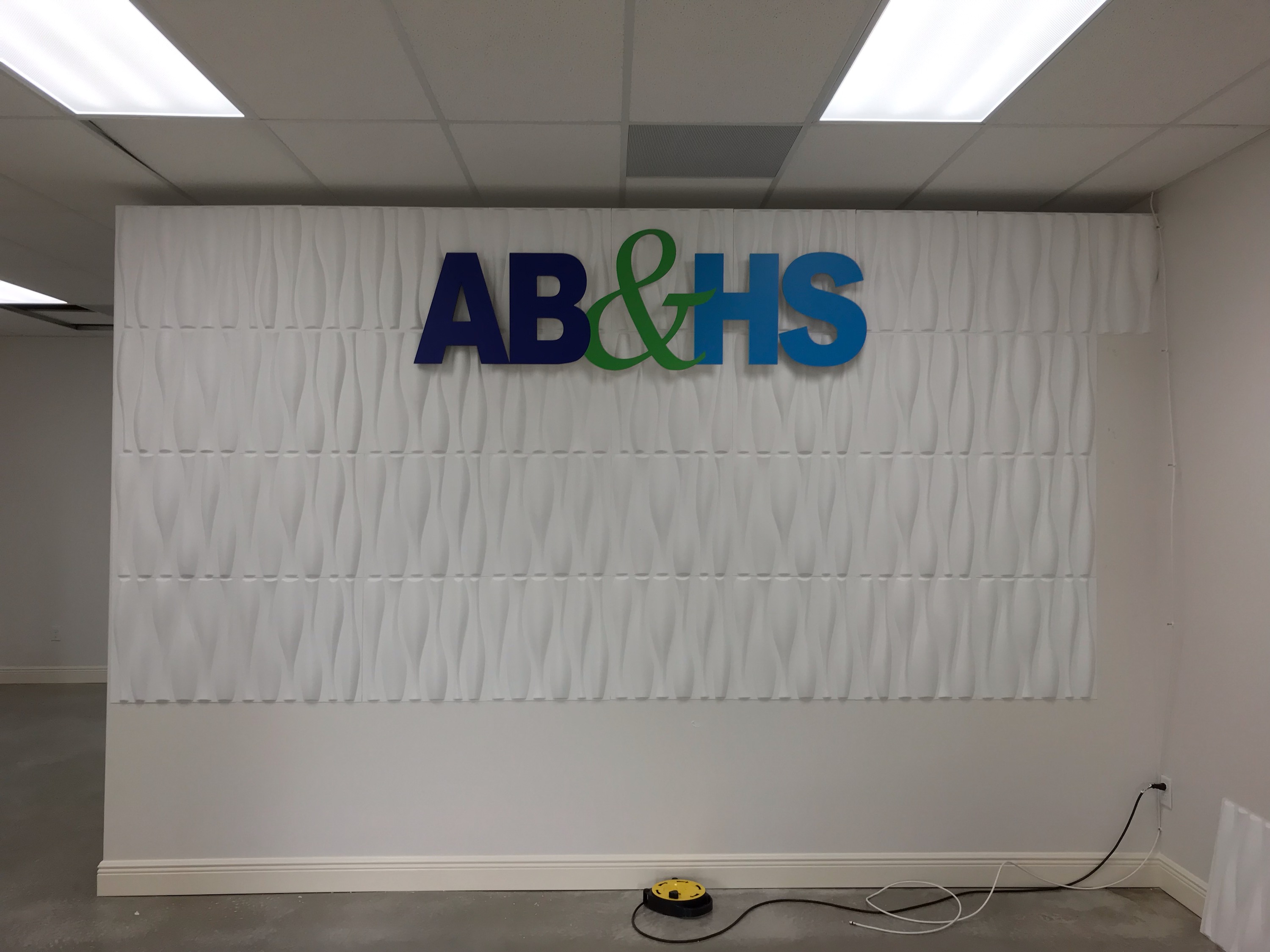

CanuckSigns
We've done it before, Install wasn't as bad as I thought, however this perticular one has spotlights overhead that cast shadows that made it almost impossible to read the sign after, the client had to redirect the lighting after we finished.
If it's ceramic, it's going to kind of suck. Going to need a few diamond core bits, etc.
Pretty sure this is a composite panel - not ceramic. They're pretty easy to drill.
CanuckSigns
Yeah the one we did was just plaster, very easy to drill

Jean Shimp
This is from Home Depot. Spec sheet says 12 x 24" glazed ceramic tile.
