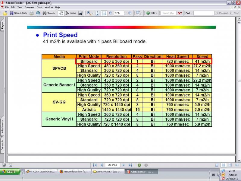

Hi,
Here are some info about XC printing speed. I hope the attachment wiil work.

On an XC-540, standard mode is usually 360 x 720, and will yield very good results with a decent profile and quality media. What is confusing is that there are actually several standard modes, which are profile dependent. So, depending on how which template the profile was built on, standard mode can range from 89 (540 x 720, 7 pass) to 151 sfph (360 x 720, 4 pass). 720 x 720 is high quality mode, and is usually overkill, with the above provisos about profiles and media. Most of the work I have seen from the 126 sfph or 151 sfph modes is more than sellable.
I realize this all begs the question of why, exactly, there are multiple "standard" modes, and all I can tell you is that I didn't name them.
