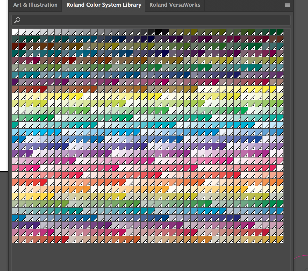

use the roland color library and choose the cyan only color.
Thank you for helping me out. I am in the roland color library in adobe illustrator. How do I choose cyan only from here?

Or just go into Illustrator, create a rectangle. add fill in CYMK and put a value of 100% in cyan and 0% in the others and print it

Sometimes I will make a spot colour in Illustrator (100% cyan for example) and in the file format tab on Versaworks specifically tell it to print that colour as 100% cyan. Try that if it helps.

Hello there,
I think the better option CMYK - Cyan =100% remaining all MYK = 0, if you go with Pantone it will print in 4 colors so ignore it, if you want to make Cyan little Dark, max Density Color management( VersaWork)
