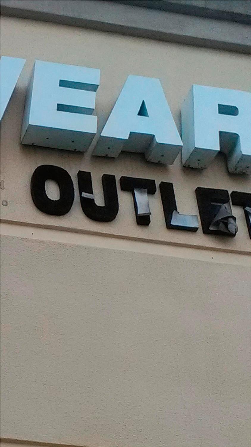

I look over at a random sign and noticed a sign that was distroyed and hope to god This is not gatorboard / gatorplast because I have a job with this media. Is this the nature of gator material? I did notice it did have a foamy back. Maybe it is a different media other than gator-

I've never trusted Gatorboard/Ultraboard for exterior use, but plenty do. The issue here is they painted it black. Once they did that, failure was kind of inevitable.
I'd say toss the letters in the garbage and swap them to 1" PVC.
